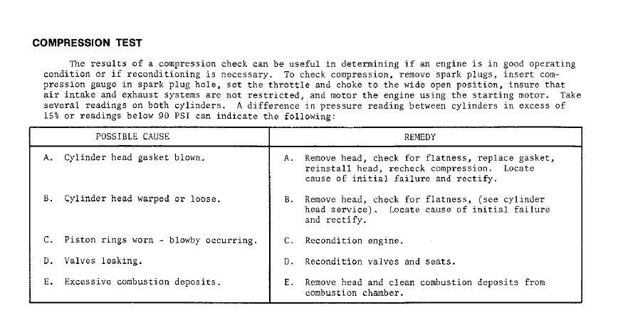

pfrederi 20,257 #6 Posted August 14, 2019 (edited) Carb factory settings are a start point. Have you tried leaning it out some more? The other plug have carbon or oil on it?? A compression test may be revealing This is from the Service manual for K532 Edit: if one cylinder reads low then repeat the test after you pour a tablespoon of heavy oil (at least straight 30 weight) in the low cylinder. if it improves you he a bad piston ring if it stays the same valve issue. Edited August 14, 2019 by pfrederi 1 Share this post Link to post Share on other sites

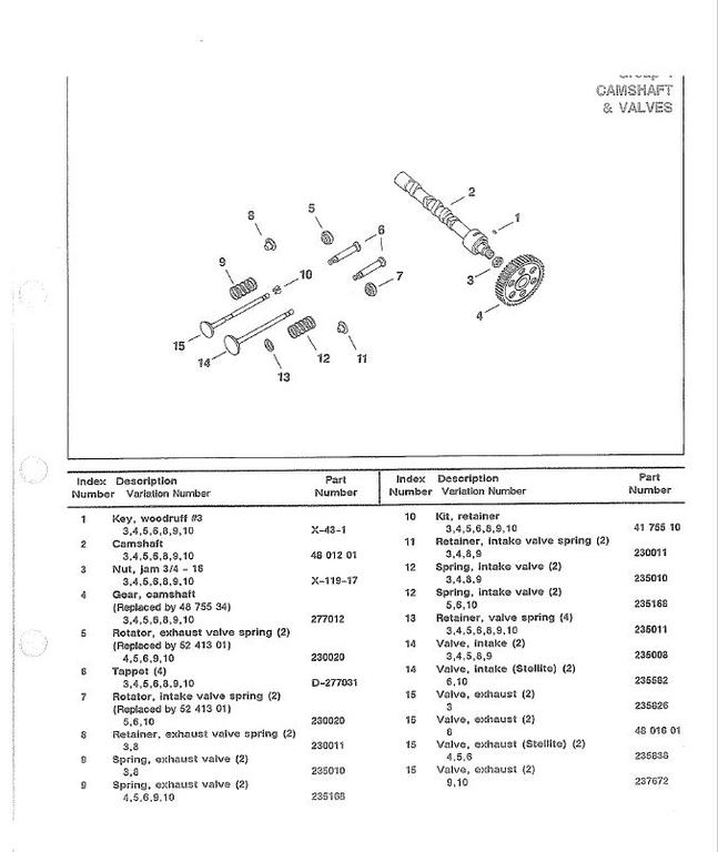

pfrederi 20,257 #8 Posted August 14, 2019 1 minute ago, ebinmaine said: Do these larger Kohler twins NOT have the ACR? That is copied out of the K 532 service manual so i guess they did not. Also took a quick look at parts manual nothing on the cam shaft. You needed to be a real man to turn one of these over with a rope 1 Share this post Link to post Share on other sites
ebinmaine 78,256 #9 Posted August 14, 2019 Just now, pfrederi said: That is copied out of the K 532 service manual so i guess they did not. Also took a quick look at parts manual nothing on the cam shaft. You needed to be a real man to turn one of these over with a rope the origin of my question is because I have a k582 that I've been fiddling with a little bit to see if I can get it to run. I would say that you not only need to be a real man, maybe three men and a boy. Share this post Link to post Share on other sites
pfrederi 20,257 #10 Posted August 14, 2019 5 minutes ago, ebinmaine said: the origin of my question is because I have a k582 that I've been fiddling with a little bit to see if I can get it to run. I would say that you not only need to be a real man, maybe three men and a boy. The service manual covers all the big twins up to the 662 (24 hp) yours is 23hp. Interesting the parts manual I have only covers the 18 and 20 engines 1 Share this post Link to post Share on other sites
