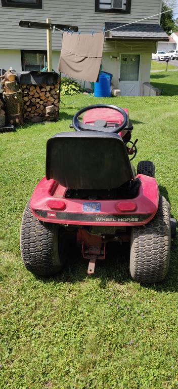

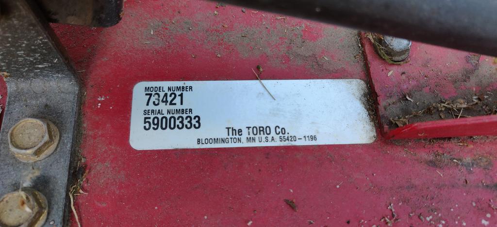

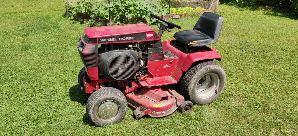

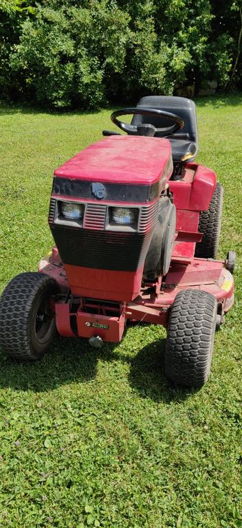

CountryRock 199 #1 Posted August 10, 2019 (edited) This Post Will Be Updated Regularly As I Work On The Tractor Brought this 416H home for service and much needed TLC. Belongs to a local game club I'm a member of. It runs well, but hasn't been looked after properly. Needs pretty much everything serviced and a good cleaning. It's equipped with a 42 inch recycler deck. I really like this tractor and I may try to buy it from the club as they have a newer cub cadet that they use more. Edited August 18, 2019 by CountryRock 1 Share this post Link to post Share on other sites

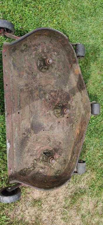

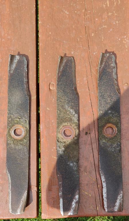

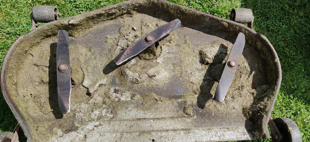

CountryRock 199 #2 Posted August 10, 2019 Pulled the deck off. Blades are absolutely trashed. Might need at least one spindle. Share this post Link to post Share on other sites
peter lena 9,561 #3 Posted August 10, 2019 that deck is screaming for a total scrape down and oil soak left in the sun upside down to soak in the oil to the metal, let the deck get hot and it will turn black from the lubrication soak. i do mine 3 times a year , zero rot , let it soak in oil upside down over winter , it will save the deck. that spindle is not difficult , i just rebuilt two 42 " r/d decks, all new bearings and seals , also replaced idler pulleys , they were major noise cause. i hope you manage to talk the club into a sale, great timing with the new plastic cub on board, looks like collective neglect on that horse, every time i see one like that i just want to save it, i hope you get it, love to help out with any ideas to bring it back, pete Share this post Link to post Share on other sites
CountryRock 199 #4 Posted August 10, 2019 Spindles still seem pretty good, no need to replace em. I scraped the deck, I'll hit it with a pressure washer another time and either oil it or paint it. Share this post Link to post Share on other sites

JaysHorse 287 #9 Posted August 11, 2019 I think the blades are different between a 42” SD and a 42”RD also. Can anyone confirm this? Share this post Link to post Share on other sites

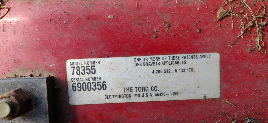

gwest_ca-(File Mod) 11,852 #10 Posted August 11, 2019 The 78355 was built as a recycler deck but this one has lost it's 86001 baffles leaving a model 78350 deck. The blades for each are different. Garry 2 Share this post Link to post Share on other sites

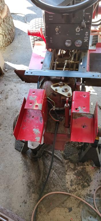

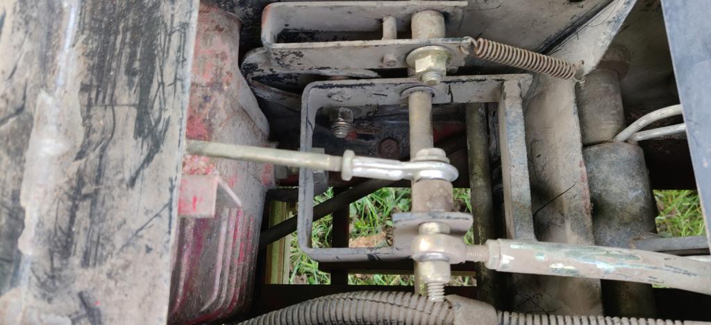

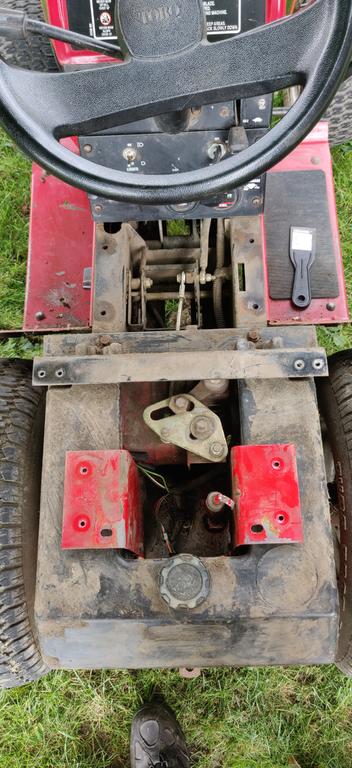

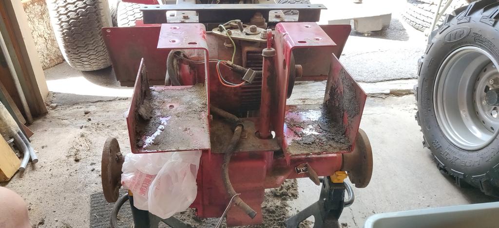

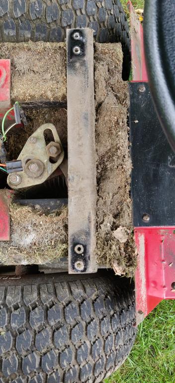

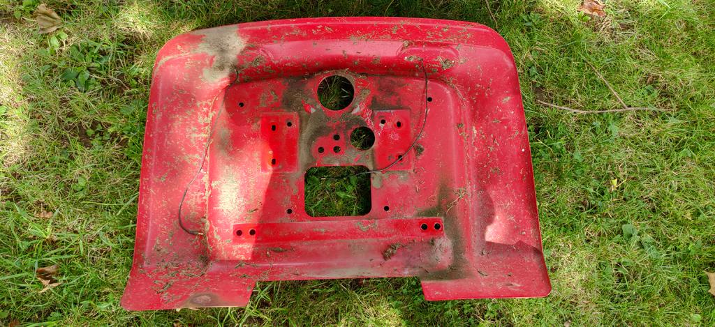

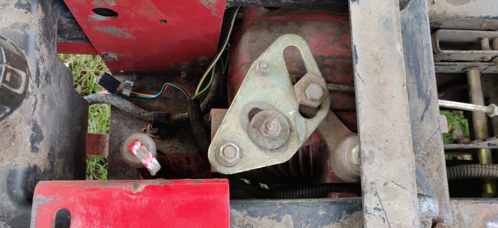

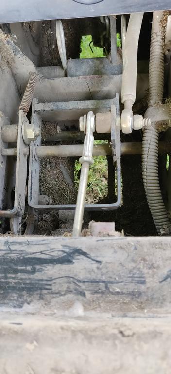

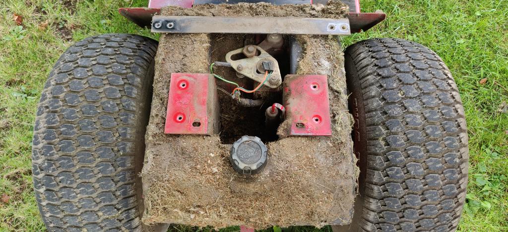

CountryRock 199 #19 Posted August 18, 2019 (edited) Warning: The following post shows Horse Abuse!! I pulled the seat and fender pan off the 416H today and was absolutely horrified at what I saw. Grass and dirt was caked all over everything, up to 2 inches thick in some spots. I began with a plastic scraper and shop vac but quickly needed to go to long screwdrivers and compressed air. I worked at it for about an hour and a half and did as much cleaning as I could before the storms started rolling in. I'm gonna have to take the fuel tank out and take the wheels off to clean it thoroughly before I can even change the hydro oil. Another issue I'm having now is the engine is surging, which began last week when I idled it down fairly quickly from high rpm and shut it off. I'm thinking maybe the governor went a little wonky but I'm not sure. One thing I do know is that I gotta try really hard to make this tractor mine. I can't bear to think about letting the club neglect it again after I get it done. Edited August 18, 2019 by CountryRock 2 1 Share this post Link to post Share on other sites

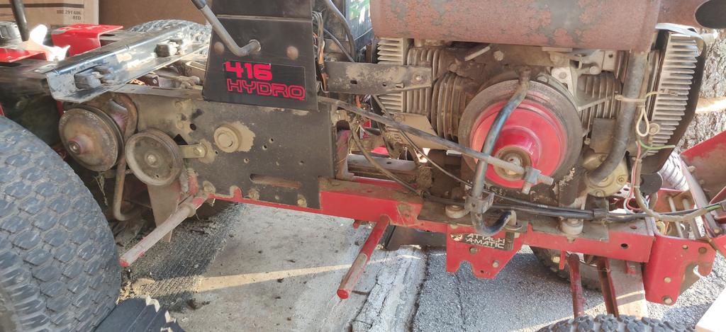

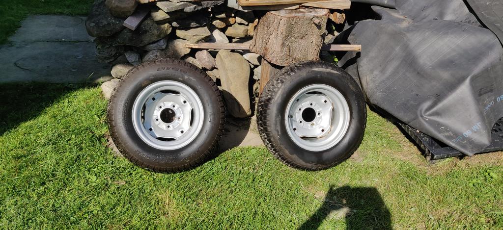

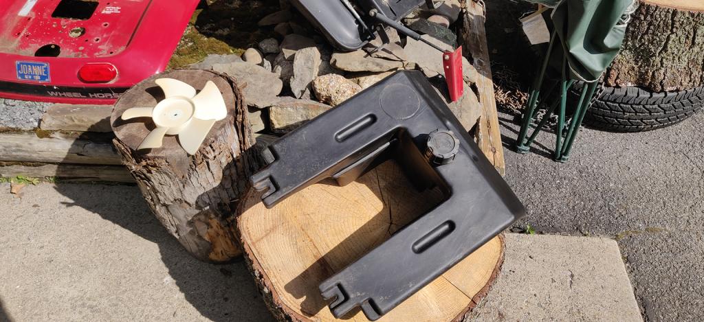

CountryRock 199 #20 Posted August 26, 2019 Busy day working on this tractor today. I pulled the wheels, gas tank and cooling fan off and finished cleaning the transaxle. The fan was covered in dirt and grass so I cleaned that up with a plastic scraper and then a simple green bath. Dumped the old gas and my dad cleaned the outside of the gas tank up while I scrubbed the wheels. Changed the hydro filter, ran new fuel line from the tank to the fuel pump, put the tank back in and wheels back on and then I drained the hydro transaxle. Filled that back up with Mobil 1 10w-30 high mileage. While I was waiting on the oil to work into the transaxle, I changed the fuel line on the outlet side of the pump and put a new fuel filter in, then I changed the trans drive belt. Buttoned everything back up and cranked it up. Fuel filter filled right up, before it barely got any fuel in it. Still need to change the impulse line and the line from the filter to the carb. Engine runs much better now, still a slight surge, but I think changing the rest of the lines and tweaking the carb a little should fix that. Now I can pull all the engine tins off and get that all cleaned up. 3 1 Share this post Link to post Share on other sites

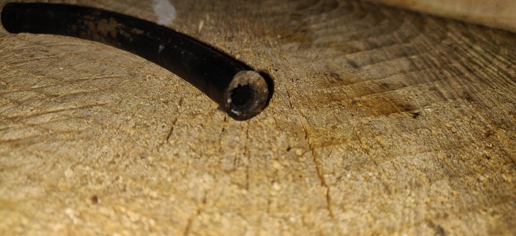

CountryRock 199 #23 Posted September 1, 2019 (edited) Didn't take much for pics today, but I finished changing the fuel line and impulse line and cleaned a bunch of dirt out from the engine block. What a pain to get the blower shroud off this engine. Whoever designed it should be beaten with a 2x4. I don't know why they thought removing throttle linkages and the coil should be required to take a shroud off! Struggled with getting the shroud back on until just after dark. Had to stop for the night before something got smashed in anger. Anyway I think the breather tube that goes into the air cleaner looks a little mangled, may replace that. Also gonna check all the electrical connections and apply dieelectric grease where needed. Gotta drop the oil yet too. Edited September 1, 2019 by CountryRock Share this post Link to post Share on other sites
lynnmor 8,265 #24 Posted September 1, 2019 I'll hold him while you swing the 2x4! Good that you thought to keep the choke closed while working in there. Those screws around the carburetor should have blue thread locker because if they come out the engine is "screwed." Yes, that hose is spent. When you install the air cleaner base, grease that hose so it slides in. 1 Share this post Link to post Share on other sites
CountryRock 199 #25 Posted September 1, 2019 (edited) @lynnmor where can I get a new breather hose? The one in the Onan parts manual is different than what toro shows and the toro one looks to be discontinued. Edited September 1, 2019 by CountryRock Share this post Link to post Share on other sites
