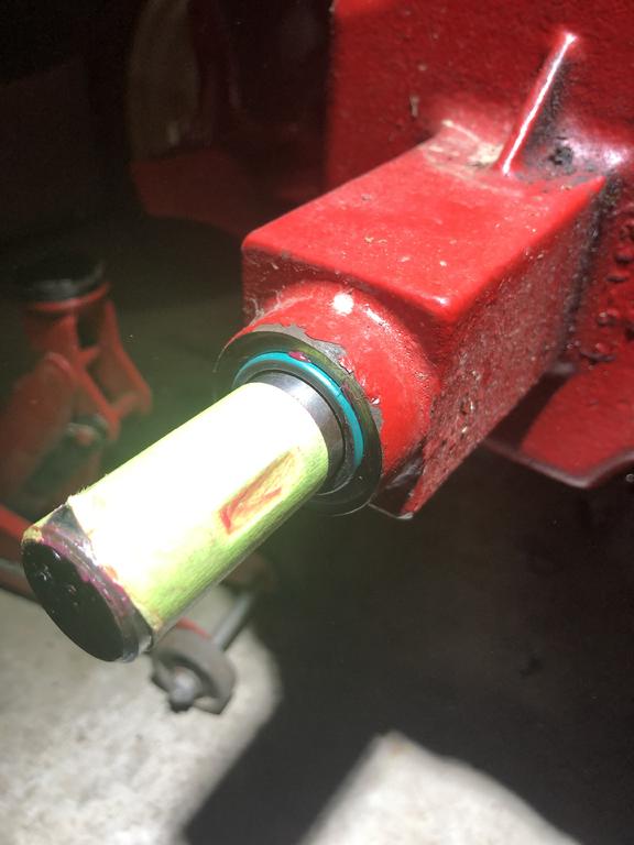

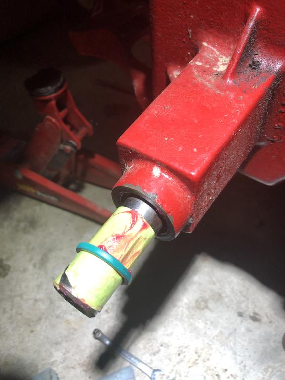

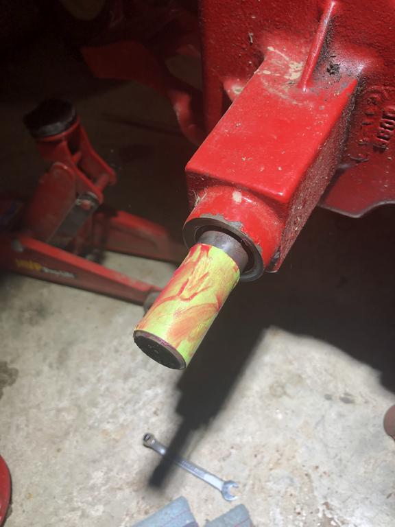

The Tuul Crib 7,354 #1 Posted August 9, 2019 (edited) I just got my seals today to replace in my 855 tractor. Model 5049 transmission. The removal of the seals was fairly easy. A sharp ice pick and a hammer took care of that problem . Matter of putting some tape on the shaft to protect the seal from the key way. A little grease on top to slide the seal in place and tap with a socket . These seals are availible from Amazon cheap! Cheaper than Napa Edited August 10, 2019 by The Tool Crib 7 Share this post Link to post Share on other sites
