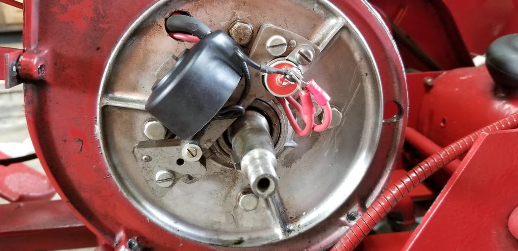

Mike'sHorseBarn 3,683 #1 Posted August 9, 2019 I need help with this k91 Kohler on a 401 wheel horse. I've put on a new coil, spark plug wire, points, condenser, spark plug, and new wires. I can't see anywhere its grounding out. I disconnected the toggle switch so I ruled that out. I don't know what else to do at this point lol Share this post Link to post Share on other sites

wallfish 20,637 #6 Posted August 10, 2019 I'm assuming those red wires are, one goes to the points and the other is for a kill switch. New points come with a coating on the contacts to prevent them from oxidizing so cleaning the 2 contact surfaces on new points should be done. Roll the engine over by hand to watch the points. Make sure they are opening and closing. Start with the points setting at .016 give it a yank, open them very slightly, give it a yank and so on. lay the plug on top of the head to pull it over easier and look for spark. I can't remember which small coil wire goes where but think the long one goes to ground and the short one to the condenser. It will not spark if they are reversed Hopefully you didn't end up with a faulty new part. Coil, condenser or plug. Share this post Link to post Share on other sites
Mike'sHorseBarn 3,683 #7 Posted August 10, 2019 54 minutes ago, wallfish said: I'm assuming those red wires are, one goes to the points and the other is for a kill switch. New points come with a coating on the contacts to prevent them from oxidizing so cleaning the 2 contact surfaces on new points should be done. Roll the engine over by hand to watch the points. Make sure they are opening and closing. Start with the points setting at .016 give it a yank, open them very slightly, give it a yank and so on. lay the plug on top of the head to pull it over easier and look for spark. I can't remember which small coil wire goes where but think the long one goes to ground and the short one to the condenser. It will not spark if they are reversed Hopefully you didn't end up with a faulty new part. Coil, condenser or plug. Well I thought short wire went to ground and long wire went to the condenser. I'll swap them tomorrow and see if that makes a difference. Hopefully I didnt ruin the coil. Share this post Link to post Share on other sites
wallfish 20,637 #8 Posted August 10, 2019 If they are switched it doesn't ruin the coil, or at least it didn't on mine. Share this post Link to post Share on other sites
Mike'sHorseBarn 3,683 #9 Posted August 10, 2019 I switched the wires and still nothing. I'm at my wits end with this at this point. I don't know what else to do. Share this post Link to post Share on other sites
gwest_ca-(File Mod) 12,489 #10 Posted August 10, 2019 Do one of those wires go to the points? If so disconnect it and connect an ohmmeter between it and the engine block/ground. Crank it over slowly by hand (spark plug out) and see if the points are making electrical contact when closed and no shorts to ground when the points are open. Garry 1 Share this post Link to post Share on other sites
