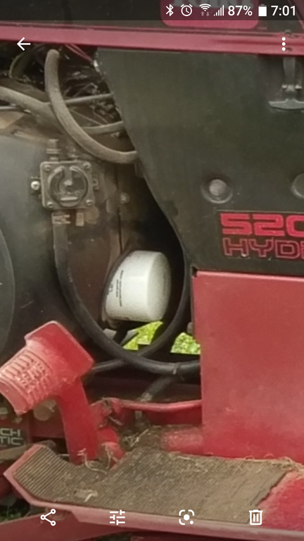

WVHillbilly520H 10,378 #2 Posted August 8, 2019 Cass, I can't tell you exactly what length but typically mine stick out past the engine tin approximately 1"-1.5" and it is a factory Onan filter but I can't remember the number... 1 Share this post Link to post Share on other sites
formariz 12,359 #3 Posted August 8, 2019 That looks like it would be correct still allowing access to the grease fitting. The one I have now is a bit short having the top of it flush with the rubber seal. Share this post Link to post Share on other sites

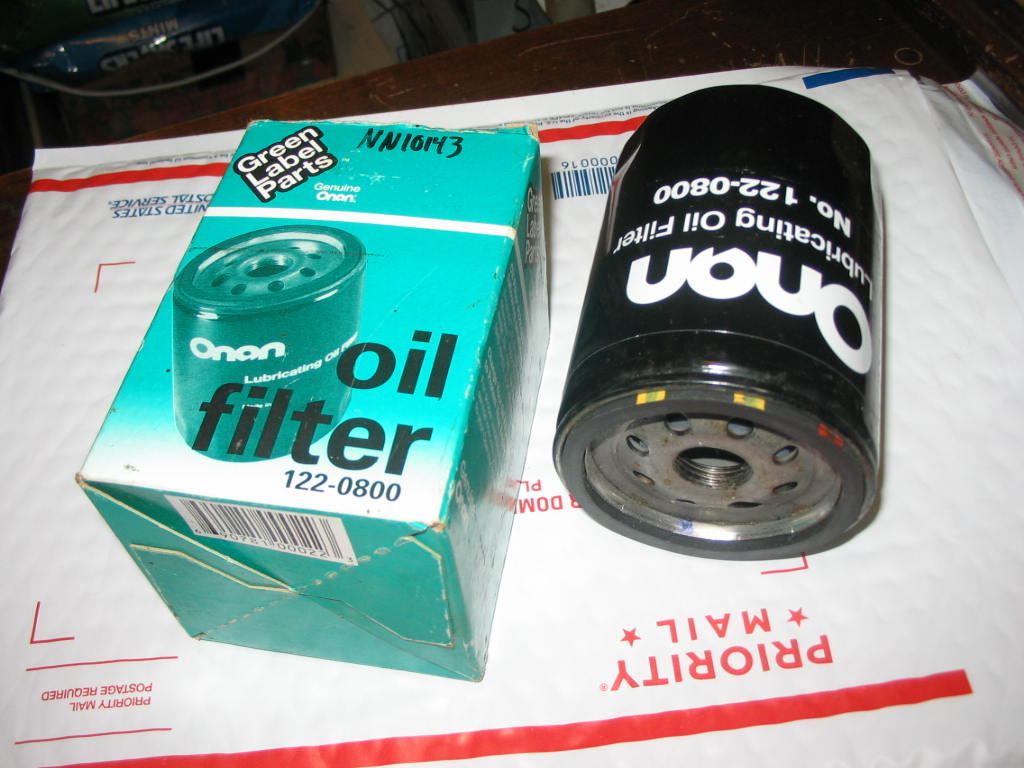

daveoman1966 3,883 #9 Posted August 9, 2019 I have a NEW Onan filter 122-0800 or NN10143 and it is 4.25" tall. Will sell it for $20 bux....includes shipping in USA. Share this post Link to post Share on other sites
lynnmor 8,844 #10 Posted August 9, 2019 The 122-0800 is the correct filter. Onan now packages the the Fleetguard #LF3339 in the green box labeled with the 122-0800 part number. You can find the Fleetguard filters online at very reasonable prices. 1 Share this post Link to post Share on other sites
