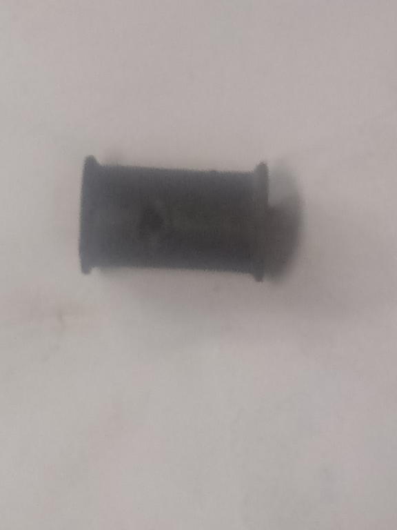

Duane de 1 #1 Posted August 8, 2019 Bought this 87, 310-8 m-12 about a yr agp. Noticed rings are worn and runs a little doggie. Had a guy start the rebuild process. Of course he reassured me he could do it and have it done within a week. Im sitting here roughly 6 months later all apart and now i have to do it myself. Downloaded pdf's. Watched a video or 2 and find myself stuck on this little black grommet or something of the sort that im not sure where its placement is. Sorry guys for rambling. Just hoping maybe someone can direct me to some web sites for idiots like myself that can really dumb this down for me so i can have my mower back. THANK YOU. 1 Share this post Link to post Share on other sites
JAinVA 4,638 #2 Posted August 8, 2019 (edited) The only place this part may go is a spacer in the breather assembly.Definitely not an internal engine part. Edited August 8, 2019 by JAinVA Share this post Link to post Share on other sites
Duane de 1 #3 Posted August 8, 2019 Ok, thx. Lol, i was looking everywhere. Almost thought going on the rod to camshaft. No real reason. Just wasnt finding it. Share this post Link to post Share on other sites
