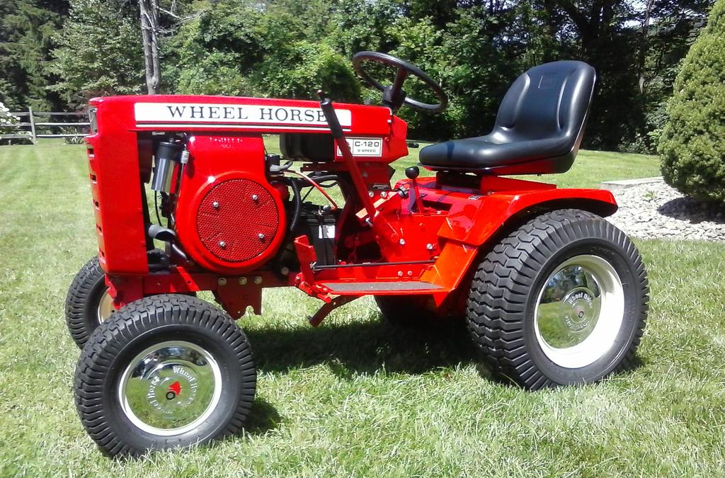

Looking for info on the correct tie down for the Battery on a 1977 C-120 8 speed model # 71-12K801. The WH Parts book shows # 105504 rod hold down with 2 # 8107 hooks which is basically the same as the 300 series is this correct. When I was at @ebinmaine a few months back his C-160 had a piece of flat stock with what looked like 2 -  1/4-20's possibly tack welded to the battery tray that the flat stock slid over with 2 nuts that appeared to be factory. On the C-120 the hooks do not appear to have anything to attach to and do not seem long enough to just slide under the tray, any help would be appreciated.  Thanks

Thanks, I will be bringing the C-120 to Maine next week, I will take another look at it, it did not seem there was anywhere to hook on under the tray ?
76c12091520h
If you can zoom in, this may help 0701191156.jpg.57ee794143547bed6e9521fc3c484762.jpg

@76c12091520hI Looked at the Battery tray and it appears the bottom left hand side of the tray half of the eyelet gone from a little bit of rust over the years, I noticed the slight angle of the left side hook from your picture and found what's left of the eyelet. On the right side looking to the rear from the PTO with a flashlight I could see the hole for the other hook behind the belt guard.   Thanks for the picture and your help. And by the way AWESOME C-120.
