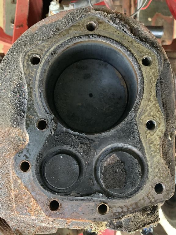

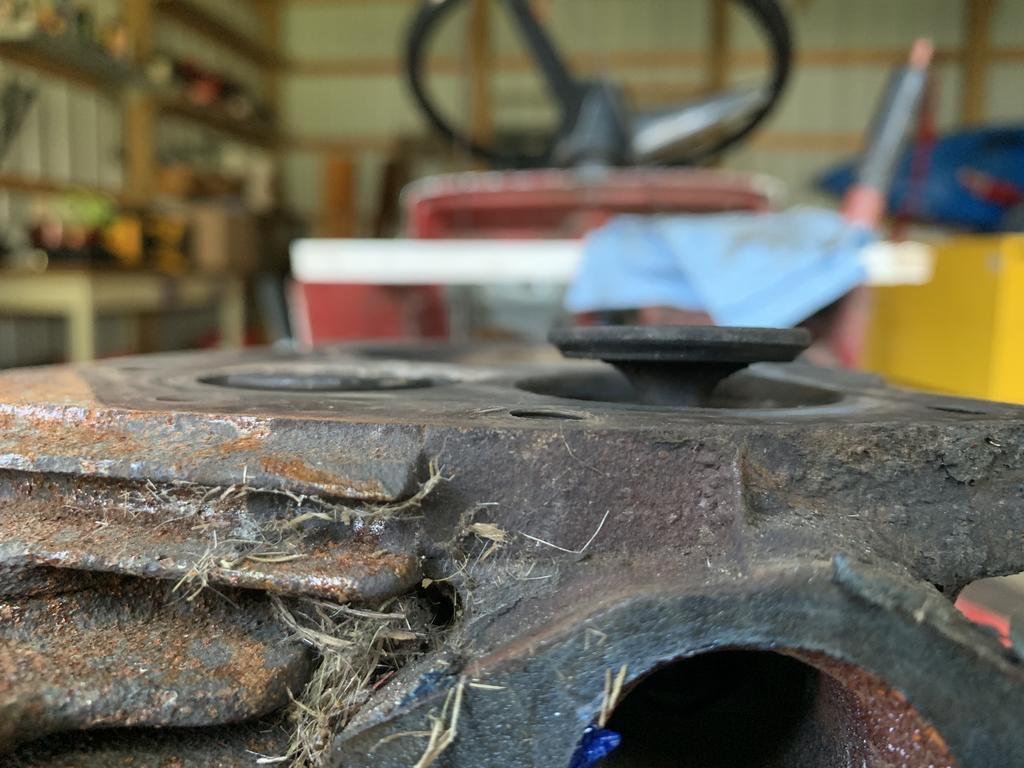

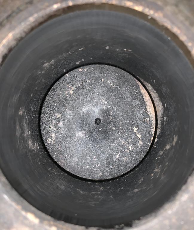

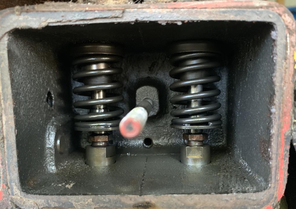

1977walleyeguy 18 #37 Posted August 14, 2019 Update : 8-14-2019 pulled the head and breather - lots of carbon on the surfaces , but nothing scary. i can physically see that the intake valve isn’t seated all the way, but I can also see that the adjustment of the intake is higher (see breather photo) is higher than that of the exhaust valve. perhaps it worked up over time? bore doesn’t look bad for a 77 machine in my opinion but I’m a novice at this. Share this post Link to post Share on other sites
1977walleyeguy 18 #42 Posted August 14, 2019 Measurements : tappet to valves at TDC exhaust .020 clearance between intake .004 (.005 is snug) clearance between. Share this post Link to post Share on other sites
