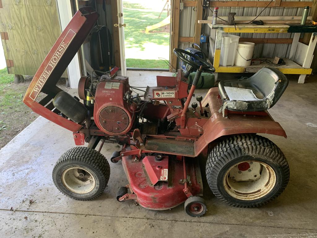

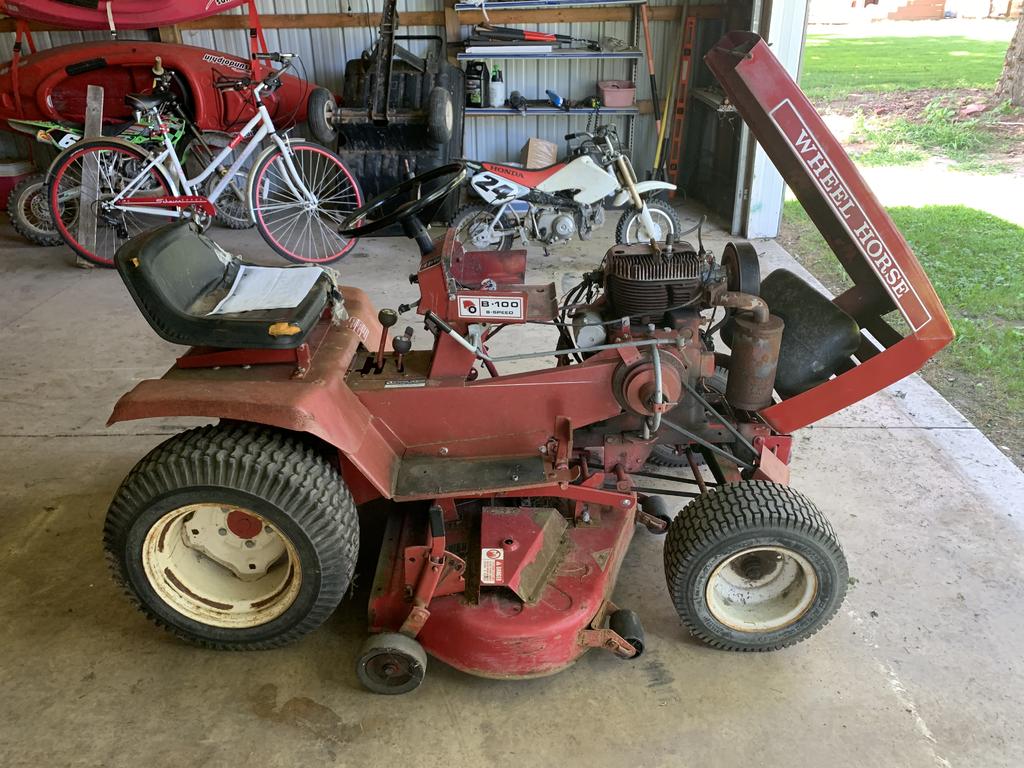

1977walleyeguy 18 #16 Posted August 10, 2019 (edited) As promised , a couple pictures of the B-100 Edited August 10, 2019 by 1977walleyeguy 1 2 Share this post Link to post Share on other sites
clueless 3,427 #17 Posted August 10, 2019 That horse is damn near new , welcome aboard. 1 Share this post Link to post Share on other sites
953 nut 67,491 #18 Posted August 10, 2019 1 hour ago, 1977walleyeguy said: couple pictures of the B-100 You may want to relocate the gas tank! 1 Share this post Link to post Share on other sites
ebinmaine 79,740 #19 Posted August 10, 2019 3 hours ago, clueless said: That horse is damn near new , welcome aboard. Share this post Link to post Share on other sites

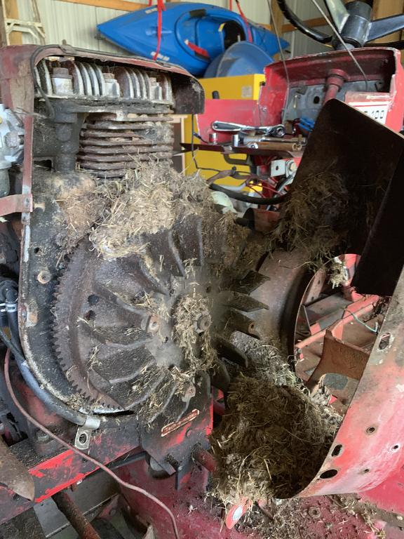

1977walleyeguy 18 #20 Posted August 11, 2019 Good eye, yeah I moved it so I could expose all the wiring. ocd question. should the positive side of the ignition coil face inwards towards the carb or outbound forwards the capacitor? second ocd question - the hot wire from the ignition switch (black wire) runs across the top of the motor and secured in place by two clips, is this correct? Share this post Link to post Share on other sites
1977walleyeguy 18 #21 Posted August 11, 2019 Good thing I’m ocd .... 1 1 Share this post Link to post Share on other sites

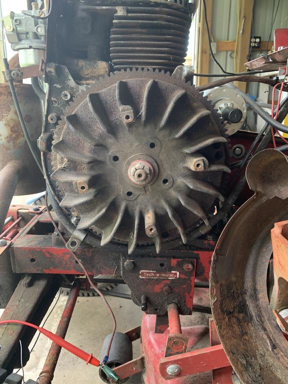

1977walleyeguy 18 #22 Posted August 11, 2019 Initial gap check on points as I received it, .035. id be surprised if it even remotely ran decent with everything I have read on this ignition system setup. 1 Share this post Link to post Share on other sites
ebinmaine 79,740 #23 Posted August 11, 2019 57 minutes ago, 1977walleyeguy said: Nice catch. That would run all kinds of hot... Share this post Link to post Share on other sites
953 nut 67,491 #24 Posted August 11, 2019 1 hour ago, 1977walleyeguy said: Initial gap check on points as I received it, .035. id be surprised if it even remotely ran decent with everything I have read on this ignition system setup. You may want to read this post on points setting. 2 hours ago, 1977walleyeguy said: Good thing I’m ocd . Great catch! While the covers are off you can use a bottle brush to clean between all the cooling fins. Share this post Link to post Share on other sites
