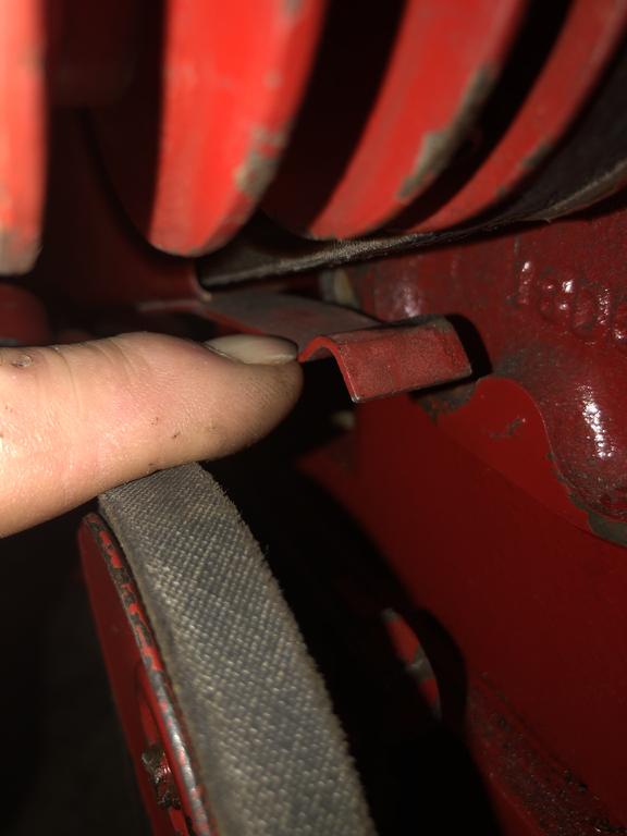

Rolled the latest one out to the drive fired it up and cant put it in gear without grinding the gears.:huh:
Readjusted the clutch pulley got LOTS of slack in the belt but the trans pulley still turning at a pretty good clip:ranting:
Not sure what should be my next move?????:confusion-helpsos:

It's probably the adjustment on the drive belt cover needs to be bent correctly to correct this problem. There is also a little arm that bolts to the motor as well that helps

BINGO!!!!!!!
Thanks

So, it is working OK now???
RJ Hamner
Yes it is.  Thanks for asking

Hey Bob that reminds me of one I had were the top wire guide was set to high off the belt. It threw the slack on to the top part of the v and the belt ran up against the clutch back on top of the V. Ruined the belt. I was seeing rubber dropping on the frame and it was slipping a touch. I think those are often overlooked.
