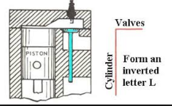

bc.gold 3,406 #3 Posted August 3, 2019 Twist up some toilet tissue or paper towel then screw it into the spark plug hole. on the compression stroke you'll hear a loud pop as the paper plug is blown free from the hole. On L head engines the spark plug is positioned over the valves. 1 Share this post Link to post Share on other sites
