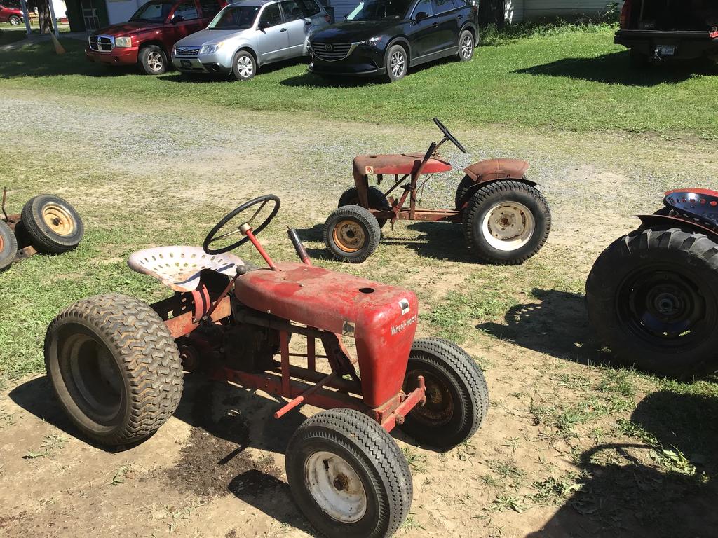

WHNJ701 4,173 #1 Posted August 3, 2019 as tractor collectors restorers etc.. we tend to accumulate extra parts. I have a stacks of front rims with no idea if they are correct for certain models?? front rims on project tractors as we know maybe miss matched or wrong. I thought this might be a good chance or we could come up with a guide to put together some sort of reference with model/year. maybe this way we could be able to pass off or trade front rims to whoever needs them. ideas thoughts?? 5 Share this post Link to post Share on other sites
ebinmaine 81,147 #2 Posted August 3, 2019 I like it. Sorted by size, width, number of holes, something like that... Share this post Link to post Share on other sites
Pullstart 71,520 #3 Posted August 3, 2019 Great idea! Funny thing, both RJ’s came with later model front wheels. I think I like the extra meat up there... though I have no idea what they really came from! They look like the Charger /60’s-70’s fronts to me. Share this post Link to post Share on other sites
oliver2-44 11,820 #4 Posted August 5, 2019 RJ & Suburban Front Rims are the same 8" dia but one difference is the holes for weights 1958-59 RJ Front Rim No Weight Holes 1960 Suburban Front Rim 1 Weight Hole 1961 Suburban Front Rim, 2 Weight holes Share this post Link to post Share on other sites

WHNJ701 4,173 #9 Posted August 8, 2019 the goal here is to have a photo of the rim and what year/models it is correct for Share this post Link to post Share on other sites
