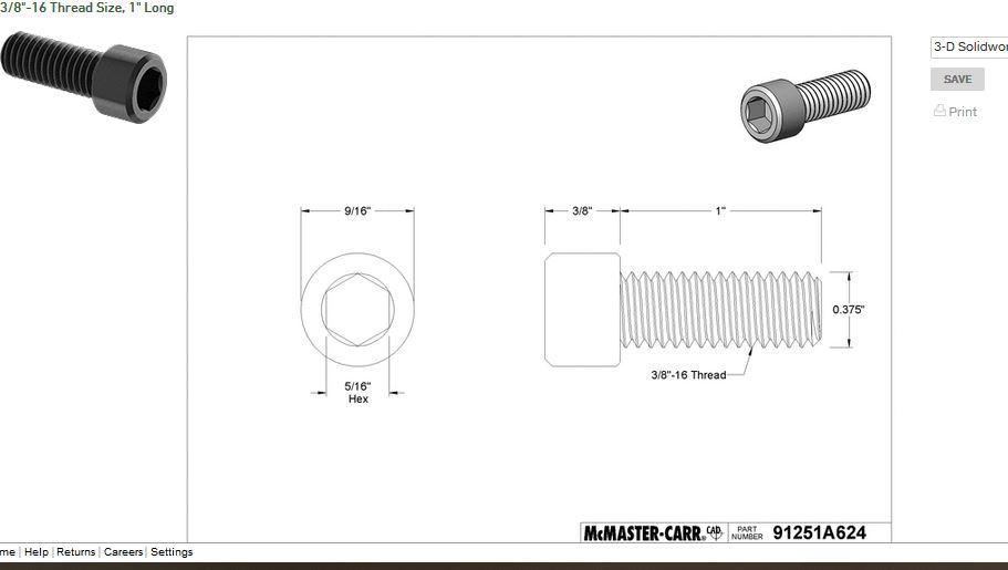

pfrederi 21,190 #7 Posted August 2, 2019 If the hex flat clears the frame but the points hit you could try these Share this post Link to post Share on other sites
littleredrider 409 #8 Posted August 3, 2019 Forgot bout those bolts lol. I have a cheap set of headers for my Yukon, and has those types of bolts, but still uses the hex, just smaller wrench size. But I need to open the holes up lil more, as well as the hole for the drain. And of course, during the middle of doing all this the battery dies for the cordless drill....I really need a garage. Accepting donations lol.... 1 Share this post Link to post Share on other sites
