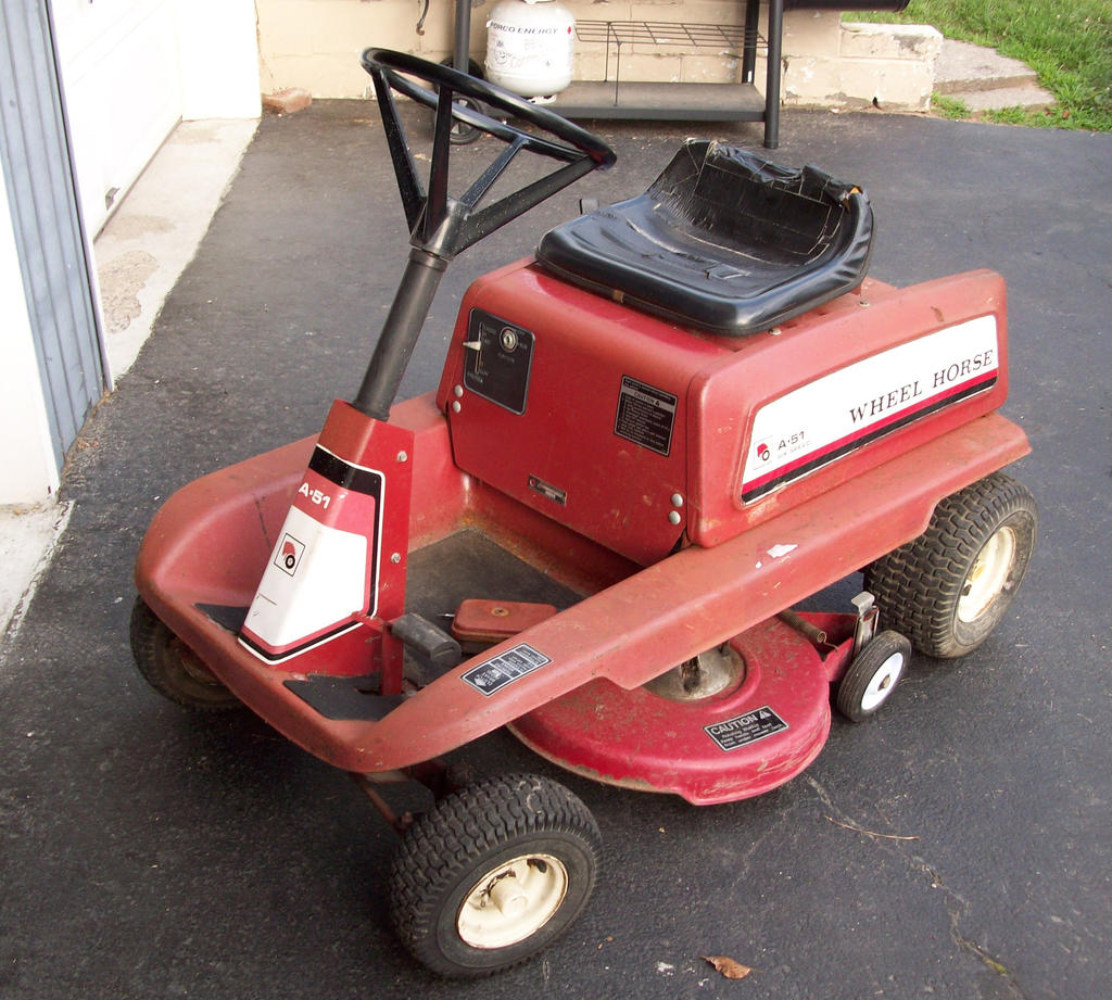

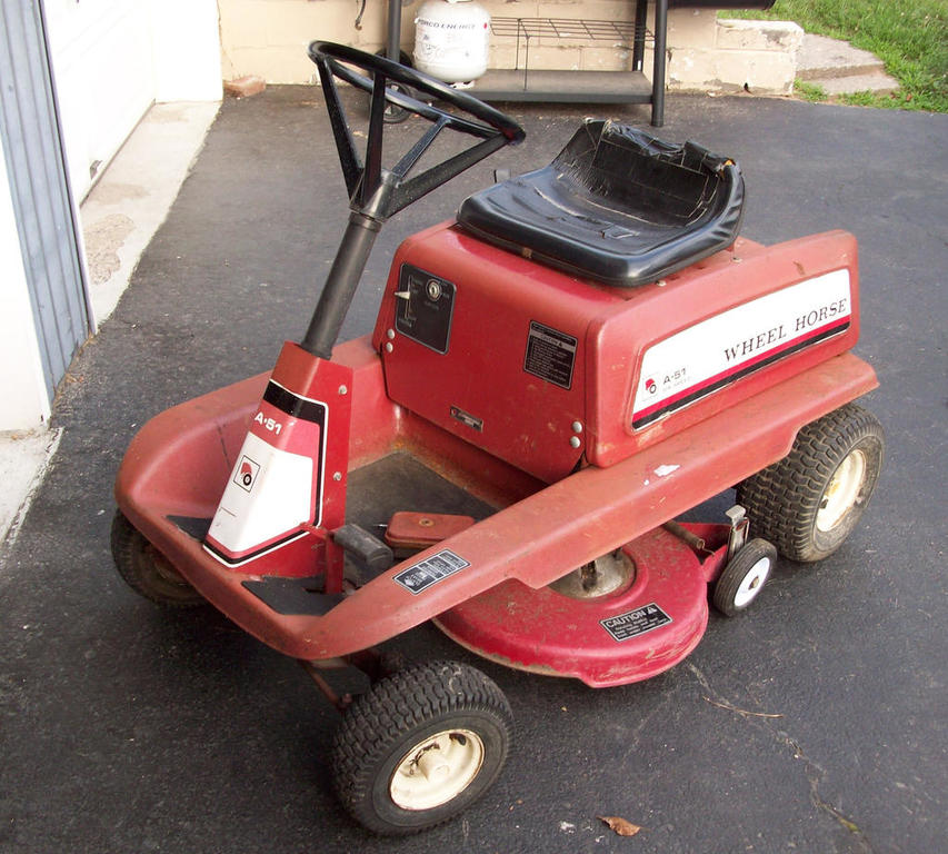

nyhorseman 7 #1 Posted July 31, 2019 Hi everyone, new to the forum, but not new to owning a Wheel Horse. I picked up an A-51 model a couple days ago. Probably paid way too much ($200) first had an issue of keeping the motor running but after pumping out the fuel and putting in Non-ethonal gas it purrs along just fine, EXCEPT, when I engage the blade. Any thoughts or ideas of why this happening? Thanks in advance 1 Share this post Link to post Share on other sites

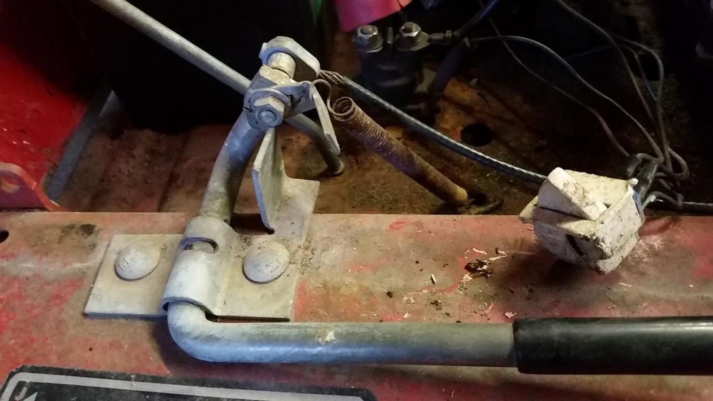

WHX?? 58,239 #4 Posted July 31, 2019 Guy You mighta paid a bit too much as they go for 50-150 around here but that one appears to be pretty rust free. . There is a switch by the deck engagement lever that looks like it belongs more on the door of a refrigerator than a mower. That might be your culprit. Does the engine kill or just run rough? This is on a A-81 but should be similar. The bracket is missing and I just have it taped closed. 1 Share this post Link to post Share on other sites

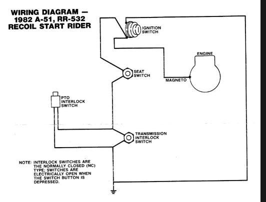

WHX?? 58,239 #5 Posted July 31, 2019 Heres a wiring diagram, rest of the manuals should be here, let us know if you have trouble finding them. Share this post Link to post Share on other sites

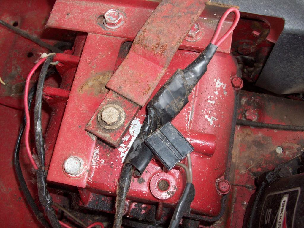

nyhorseman 7 #7 Posted July 31, 2019 Oops, don't know what I did there, anyways, no switch to be found and no switch on seat as well, though I did find this, looks like someone may have removed the switch. And the engine just dies when engaging, doesn't even sputter Share this post Link to post Share on other sites
Pullstart 71,333 #8 Posted July 31, 2019 It looks like that empty plug should be jumped, then try it! Share this post Link to post Share on other sites
nyhorseman 7 #9 Posted July 31, 2019 Okay, figured it out, I obviously was trying to engage the blades too fast, working fine, just mowed the front yard thanks for the help 1 3 Share this post Link to post Share on other sites
Yossarian 210 #10 Posted July 31, 2019 4 hours ago, pullstart said: It looks like that empty plug should be jumped, then try it! It looks like the other half of the plug is under that electrical tape and jumped. My bet is that it had come loose and fiddling with it knocked it back into contact. If it happens again yank that tape and redo the jumper. Share this post Link to post Share on other sites
