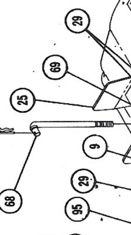

The Tuul Crib 7,354 #1 Posted July 30, 2019 I'm working on this RM 327 deck and lm looking through my parts and l cant find the part that connects to the lift arm to raise the deck. I could probably make one but lm not sure the length or thread size. Anyone know or have one? It is number 68 . Thanx !! Share this post Link to post Share on other sites
roadapples 6,987 #2 Posted July 31, 2019 Should be 3/8". Mine just broke during last mowing. Plan on replacing with a length of chain... Share this post Link to post Share on other sites

71_Bronco 1,073 #6 Posted May 28, 2020 Mine is a little messed up too on my deck (36" gear drive). I bought a 3/8" eye bolt to put in the deck, and a shackle for the lift arm. I'm going to run either some form of chain between them or a loop of cable, haven't decided yet. Cable will probably be quieter, but chain stronger (not that it needs to be super strong). Share this post Link to post Share on other sites
