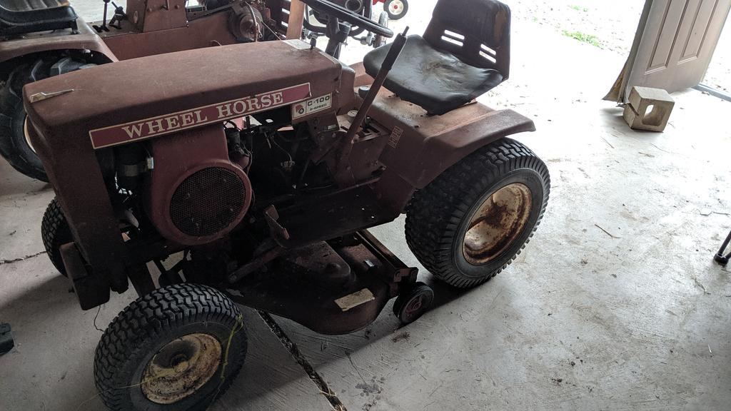

cslxt8 4 #1 Posted July 29, 2019 (edited) Hello, I just acquired a c-100 in pretty decent shape. I am wanting to use it with my tiller but it doesn't appear to have a cable for the rear lift. It does have a tube where it appears a cable should pass through. This is a different design than my c-111 with the rockshaft connected to the cable. Would anyone be able to point me in the right direction on how it should route through and maybe the correct length? I have not been able to find a manual to assist yet. Thanks, C Edited July 29, 2019 by cslxt8 Added picture Share this post Link to post Share on other sites

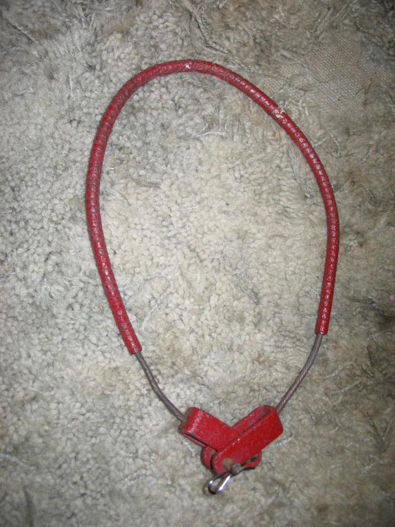

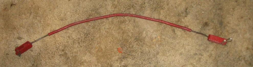

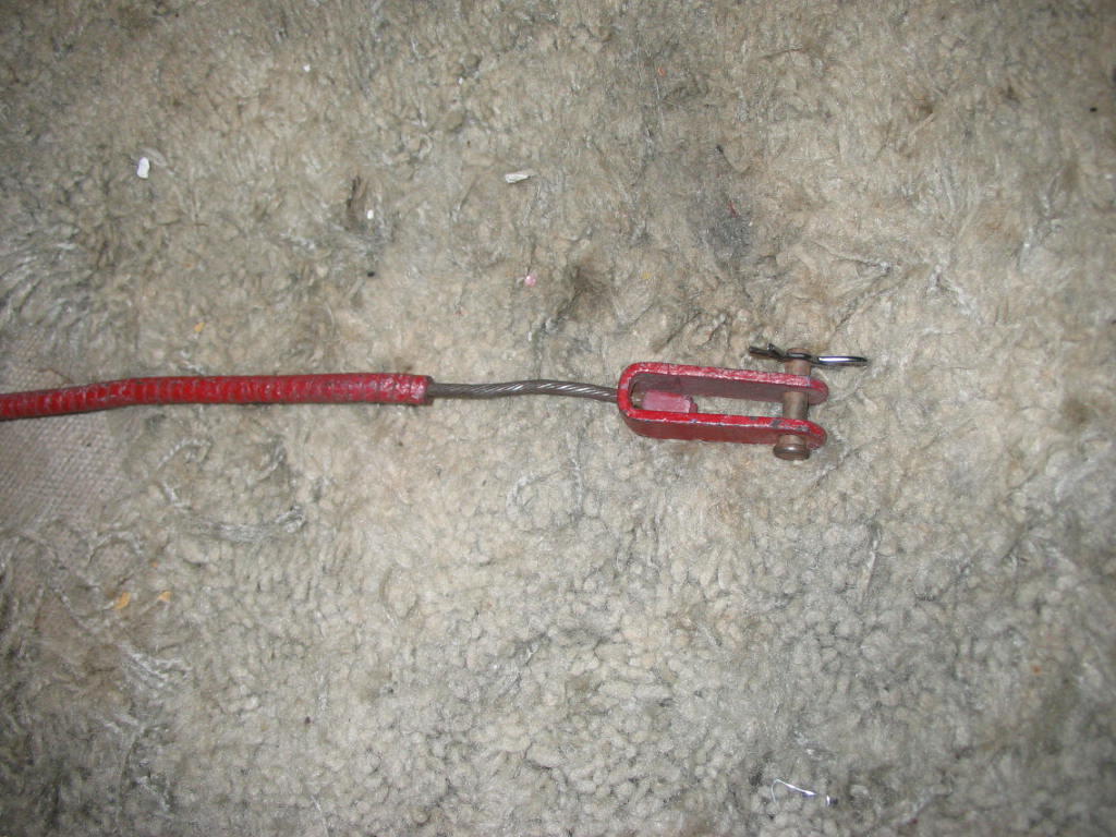

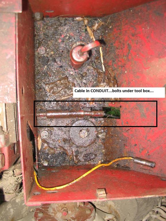

daveoman1966 3,884 #2 Posted July 29, 2019 Rear lift cable for the C-100 is 22" long ...in a conduit... that fits under the tool box. It looks like this and is part # 8277. 2 Share this post Link to post Share on other sites

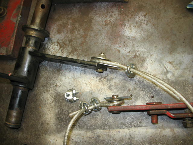

JoeM 10,080 #5 Posted July 29, 2019 I have gotten by with some aircraft cable and saddle clamps from the hardware store. Not as fancy but it did work. Share this post Link to post Share on other sites

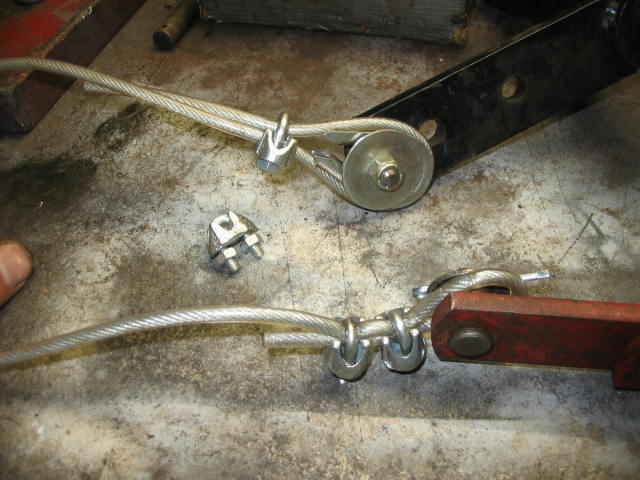

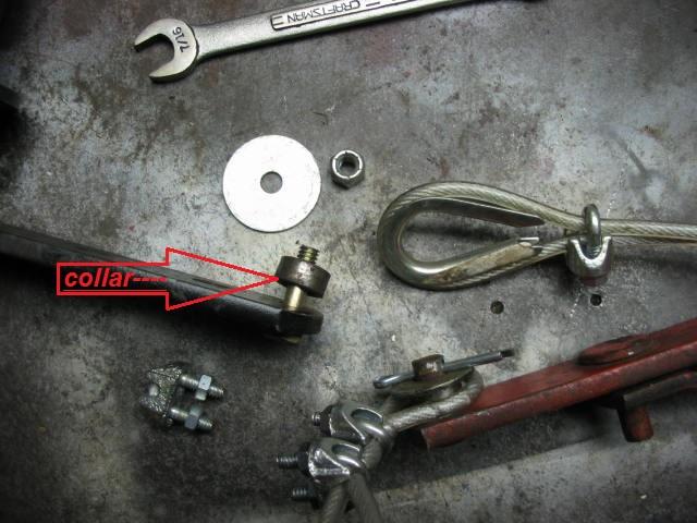

daveoman1966 3,884 #6 Posted July 29, 2019 Something ,like this...all from hardware store. 36-46" shielded cable, 2 'loops', 4 saddle clamps, 2 collars, 2 fender washers,. I have the saddle clamps backward, but you get the idea. 1 Share this post Link to post Share on other sites
cslxt8 4 #7 Posted July 30, 2019 That's a really good idea! Thanks for throwing that out there. I may have the parts laying around the garage to put something like this together. Share this post Link to post Share on other sites
