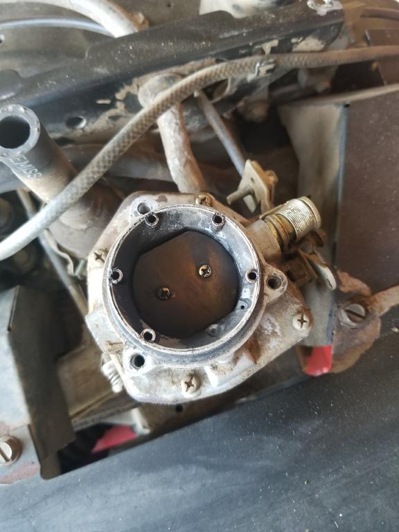

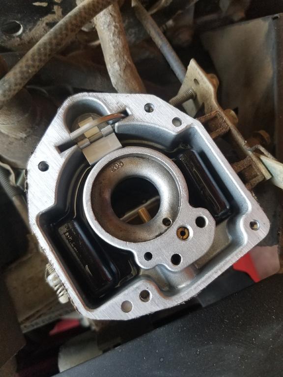

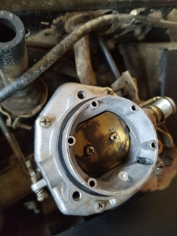

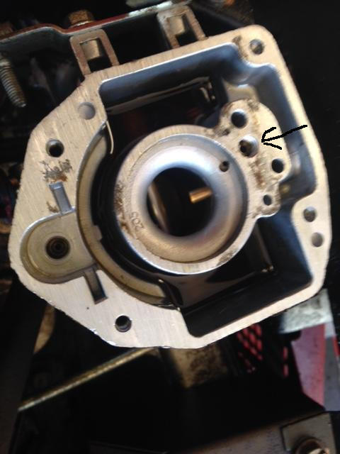

JoeM 10,310 #16 Posted August 5, 2019 Just cleaned up a 16 Onan carb doing the same thing, I took a few pics, Tried to get a pic of gunk in float bowl, you can see some of the debris. First removed air cleaner assy, unscrewed the 4 Phillips screws, I close the choke and throttle when removing screws incase I drop one, remove the float assy, and wipe out old gas and debris, spray down the area with carb cleaner, wipe again. I also spray the metering tube to make sure the ports are open. Then use compressed air to blow out and repeat as needed. This machine ran pretty good and this solved my surging. Share this post Link to post Share on other sites
cleat 9,345 #17 Posted August 6, 2019 You need to unscrew and clean this tube as well. It has some very small holes in it that need to be clean. 1 Share this post Link to post Share on other sites
