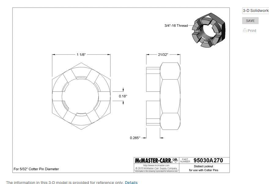

Skipper 1,792 #1 Posted July 25, 2019 I have been looking, but can't find the part number, or dimensions, for the castle nut that tightens the front wheel bearing, and holds it all in place. Can anyone help me out? Perhaps also where to go get them? Thanks 1 Share this post Link to post Share on other sites
gwest_ca-(File Mod) 12,276 #2 Posted July 25, 2019 Toro 32136-5 is a 3/4"-16 Castellated SAE fine thread nut In the parts list it is on the tire and wheel page. Garry 2 1 Share this post Link to post Share on other sites

pfrederi 20,658 #5 Posted July 25, 2019 McMaster but I do not know if they ship overseas 2 1 1 Share this post Link to post Share on other sites
Skipper 1,792 #6 Posted July 27, 2019 On 7/25/2019 at 3:28 PM, pfrederi said: McMaster but I do not know if they ship overseas Thanks Paul. That was exactly what I was looking for. And thanks to all others who helped find the nut size. Being a millimeter guy, it is sometimes a hassle to figure out what a nut, bolt and so on is called in the states. The shipping won't be a problem. Kind of got that down to a t by now Thanks everybody 2 Share this post Link to post Share on other sites
