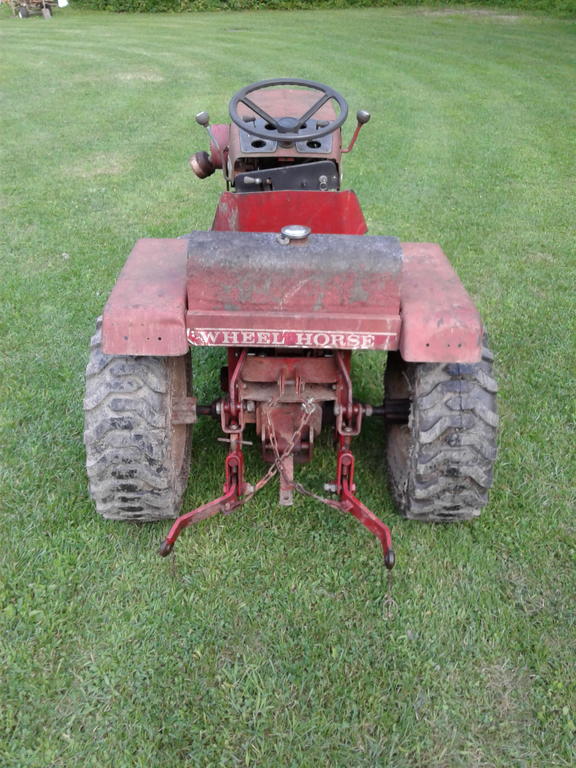

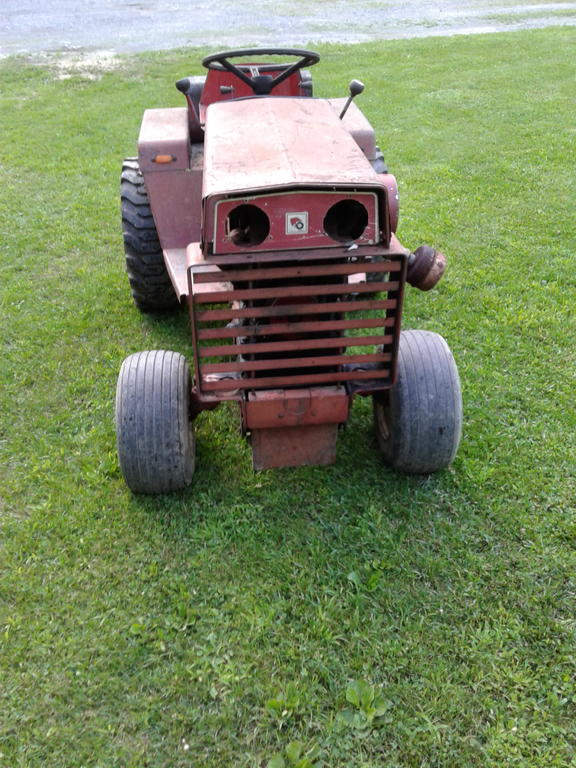

Stike 204 #1 Posted July 24, 2019 Picked up this old horse from a farm down the road from me with a snow blower that's missing some parts and a heavy duty belly mower deck, not sure the make not wheel horse but adapted to fit, 3 point hitch came with cylinder but no hoses and bent lift arm but some heat and sweat should fix that, any help with the sizes on the hoses would be much appreciated, not sure about the year but it cost me half a six pack, oil change in the engine and hydro and drove her home about a quarter mile hydro seems strong but linkage is iffy works but not centering right, anyway just throwing this out there probably alot of questions to come but any thoughts on how to go forward? 7 3 Share this post Link to post Share on other sites
oliver2-44 11,820 #2 Posted July 24, 2019 Sounds like it needs some TLC, but you've got a good horse to work with. Share this post Link to post Share on other sites
Retired Wrencher 7,037 #3 Posted July 24, 2019 The side shot looks to be a D series 180? a little tlc she will be a fine worker. Share this post Link to post Share on other sites
rmaynard 17,644 #4 Posted July 24, 2019 (edited) Looks like a 1974 or 1975 D-160 Edited July 24, 2019 by rmaynard 2 Share this post Link to post Share on other sites
Sparky-(Admin) 26,693 #5 Posted July 24, 2019 Yep, it’s a D160. Good luck with it and there are plenty of guys here who know all the quirks of the D’s and can get ya straightened out. 1 Share this post Link to post Share on other sites

bottjernat1 2,197 #9 Posted July 24, 2019 yep a d-160 great machine i want to get my hands on one! My biggest horse right now is a 953 bought from the original owners son. His dad bought it new at an old local wheelhorse dealer that went out of business before i was even born. I love it. Mine is all original exsept a new paint job by the guys dad. he got bored and repainted it. 1 Share this post Link to post Share on other sites
Herder 2,356 #10 Posted July 24, 2019 She's a keeper. 16 HP K-series is reliable and long lasting. Even the ugly one need a good home. Share this post Link to post Share on other sites
pfrederi 21,308 #11 Posted July 24, 2019 D series linkages can be frustrating. You have an early version that used the the motion control lever (lower slot to the rear) to set the parking brake. Miss use will damage the hydro unit. Never move it to the lower rear slot while moving!!!!. To adjust the linkages check out this manual. You want the 1974 info Share this post Link to post Share on other sites
Stike 204 #12 Posted July 24, 2019 Thanks for the replies, we split the six pack while I did the oil, thanks for the manual download, got the linkage set to center from the manual but the hole in the handle is oval shaped now so I can't get the parking brake set right, plan to weld the hole shut and drill it out to the correct size. Does anyone know where I can find a parts manual for the 1974 d160 I've looked but no luck. Any thoughts on putting a front end loader and backhoe on this machine? I have been slowly getting everything together for the builds I have all the cylinders, valves, pump and most of the steel, the loader is almost done and I was going to put them on my c195 but now thinking this may be a better option given the heavier frame. 1 Share this post Link to post Share on other sites

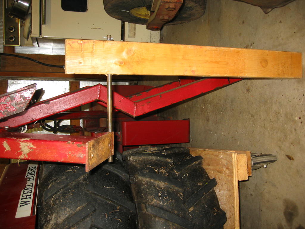

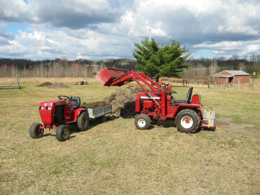

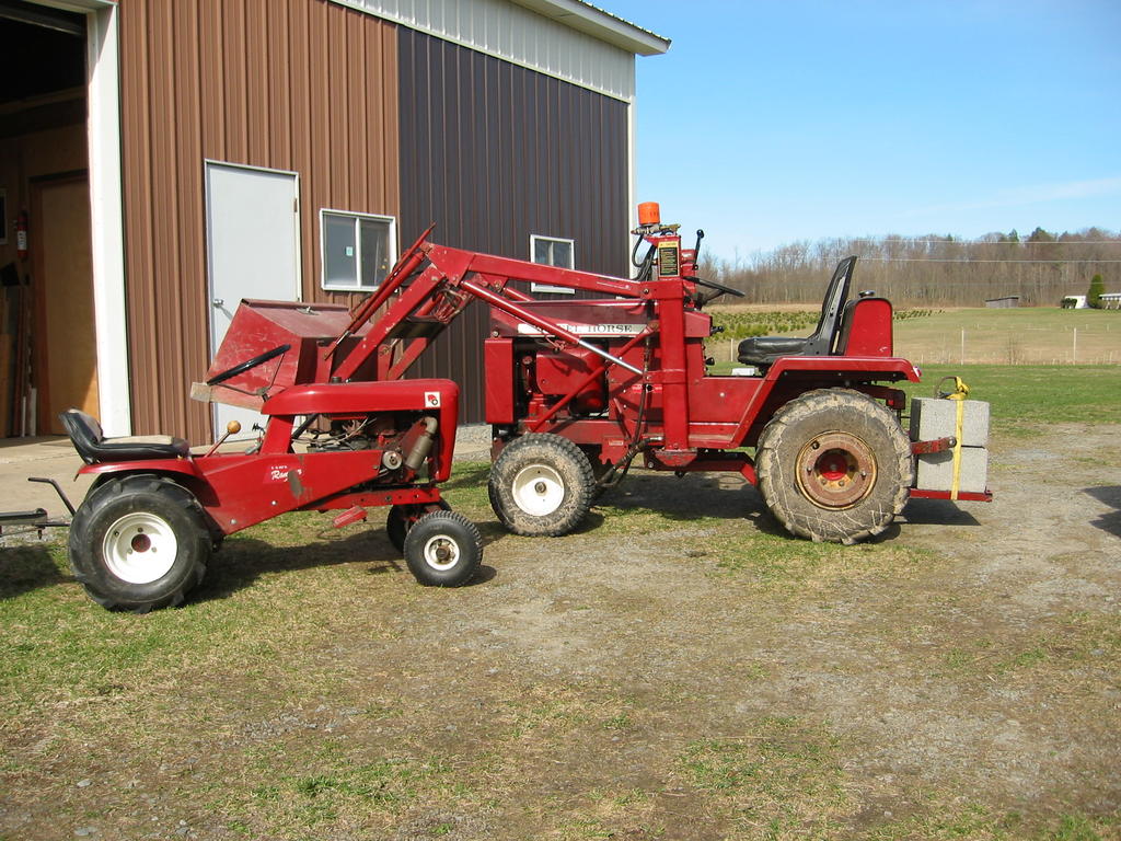

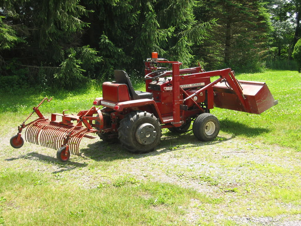

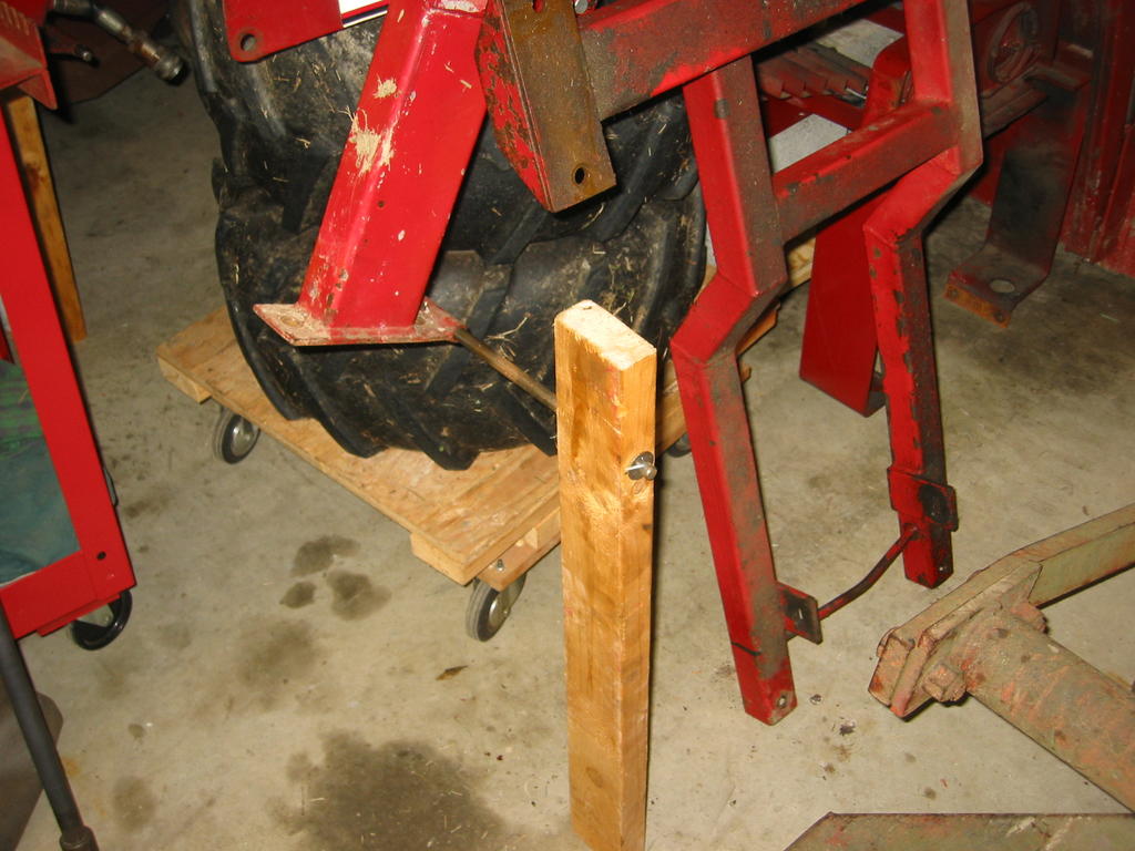

pfrederi 21,308 #14 Posted July 25, 2019 Parts manual can be downloaded here The wider heavier frame is a big plus for a loader. If you are going to use it for heavier stuff you should try to round up The 1" front axle and spindles. Also several have replaced the front wheels with trailer hubs and wheel. (I haven't done that yet but I Do not run heavy loads on rough terrain.) As you design your subframe make it long enough to extend to the back so you can hang a weight box on it. Sorry these are the best subframe pics i have. 1 1 Share this post Link to post Share on other sites
Stike 204 #15 Posted July 25, 2019 Thanks for the info and pictures, those are some fine looking horses you have there, did you build the loader yourself? Pacer, I agree that linkage is nothing like I've ever seen and a block off plate may be in my future even though I did get the shift arm welded, drilled and pinned tight today I guess I'll see how it is when I get time to put it back together. This is my first d series after wanting one for a long time and so far I love it. Share this post Link to post Share on other sites
