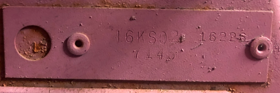

11ccantley 0 #1 Posted July 23, 2019 Hello all, I have what i believe to be a Wheel Horse C-160 with a Kholer engine and automatic (hydro) transmission. I have attached a photo of the model tag below (dont mind the pink lol) Ill explain later Can anyone help me with identifying if this tractor has posi / limited slip? And if not, what is required to make it limited slip. Share this post Link to post Share on other sites
pfrederi 21,274 #2 Posted July 23, 2019 No limited slip. You could round up a 10 pinion differential and use that but you may also have to change the mushroom gear depending what style you have 1 Share this post Link to post Share on other sites
stevasaurus 23,861 #3 Posted July 23, 2019 Right on Paul...1976 C-160 Auto with 8 pinion trans-axle. It looks like he would have the 1 piece mushroom gear, so he would need the 2 piece mushroom gear with the 10 pinion trans-axle to do that. If he wants to. BTW....Welcome to Red Square 1 Share this post Link to post Share on other sites
gwest_ca-(File Mod) 12,519 #4 Posted July 23, 2019 I think this is a 1977 model 71-16KS02 Click on the fuzzy picture Garry Share this post Link to post Share on other sites
