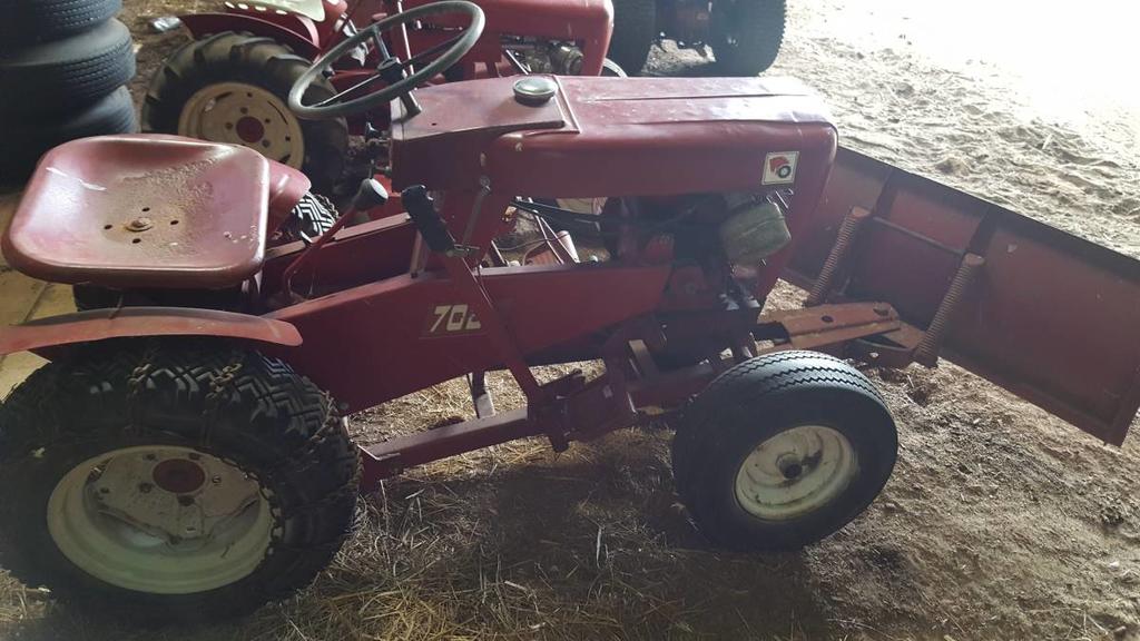

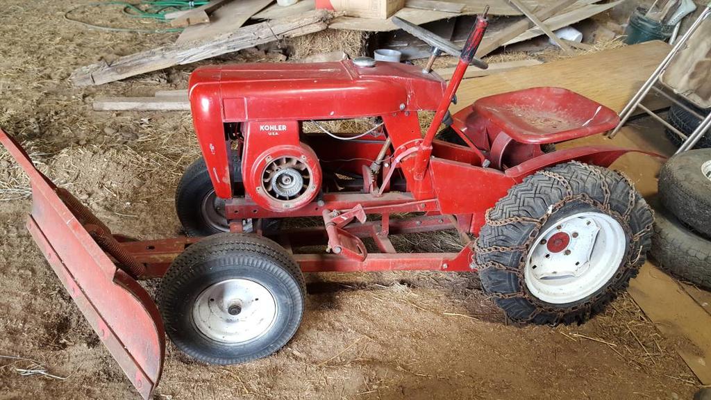

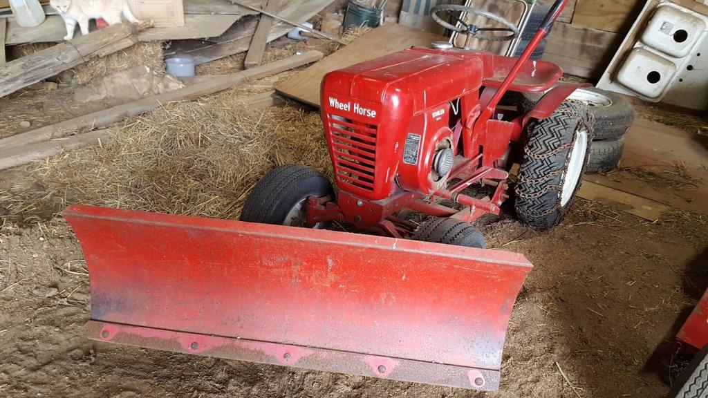

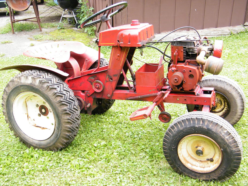

mhlmeader 689 #1 Posted July 23, 2019 Hi folks, might go look at this this afternoon. He claims it's original, but I thought 702s had a starter generator? My dad's does. Possible repower? I'm confused. He also has the recoil assembly, but it s in pieces and needs repair right now. Any ideas? Thanks Share this post Link to post Share on other sites
953 nut 69,133 #2 Posted July 23, 2019 The manual shows the 702 having a S/G, but I suspect in 1962 it could be bought with a pull start too. It may have been a customer requested option for the more thrifty buyer, I didn't see a battery box in the pictured so I'm inclined to think it is a factory made pull start. 2 1 Share this post Link to post Share on other sites
Pullstart 71,207 #3 Posted July 23, 2019 I know just the guy for a pull start! 6 Share this post Link to post Share on other sites
rmaynard 17,574 #4 Posted July 23, 2019 What is interesting is that the manual shows only a wiring diagram with battery. The parts list shows a battery box, which in 1962 was welded to the frame. There is no optional pull-start engine listed in parts. Does this tractor still have a serial number tag? What is the model and spec number on the engine? 1 Share this post Link to post Share on other sites
Racinbob 13,135 #5 Posted July 23, 2019 ……...But, the 1962 sales brochure states that all the tractors were identical other than the horsepower and electric or pull start. I'm not sure exactly how they meant that but it sounds like you could ask for either. 1 1 Share this post Link to post Share on other sites
rmaynard 17,574 #6 Posted July 23, 2019 20 minutes ago, Racinbob said: ……...But, the 1962 sales brochure states that all the tractors were identical other than the horsepower and electric or pull start. I'm not sure exactly how they meant that but it sounds like you could ask for either. In 1962 you had the 702, 502, and 552. The 702 had an electric start Kohler 7hp, 552 had the Lawson electric start 5.5hp, and the 502 was a Lawson 5.5hp pull-start. They all used the same frame, and had battery boxes even though the 502 was a pull-start. Share this post Link to post Share on other sites

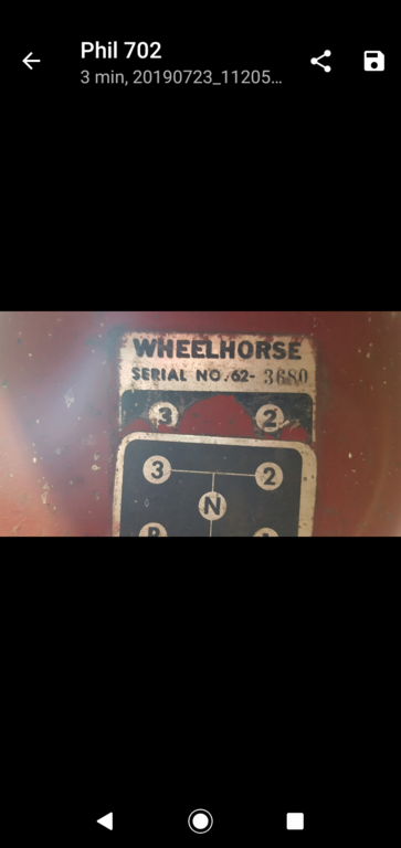

mhlmeader 689 #7 Posted July 23, 2019 I ask the seller for pics of the engine tag and dash area. No response yet. But thanks for the info so far. Share this post Link to post Share on other sites

Racinbob 13,135 #9 Posted July 23, 2019 49 minutes ago, rmaynard said: In 1962 you had the 702, 502, and 552. The 702 had an electric start Kohler 7hp, 552 had the Lawson electric start 5.5hp, and the 502 was a Lawson 5.5hp pull-start. They all used the same frame, and had battery boxes even though the 502 was a pull-start. Very true but, especially true in the earlier years, the dealers were quick to offer what the customer wanted. I was with my Dad when he was looking at a 704 new. He was contemplating it when the dealer said that if he wanted electric start he'd do it. No, not a 754 but a 704 electric start maintaining a 704 hood. He actually wanted a pull start and ended up buying it. If the swap would have been done it wouldn't have been 'factory' but I'm sure over the years the word would have been "bought new with the electric start' and the presumption would have been from the factory. I'm sure that's happened a lot with these tractors. If he would have been looking in 1962 I can hear him saying "hmmmm, I want a pull start but I don't want a Tecky" (he was Kohler all the way). It's easy to guess what the dealer would have done. The lack of a battery box is odd though. 3 Share this post Link to post Share on other sites
Racinbob 13,135 #10 Posted July 23, 2019 4 hours ago, mhlmeader said: Hi folks, might go look at this this afternoon. He claims it's original, but I thought 702s had a starter generator? My dad's does. Possible repower? I'm confused. He also has the recoil assembly, but it s in pieces and needs repair right now. Any ideas? Thanks Are my eyes messing with me looking at the blade frame? It looks to be attached in the front of the transmission. 1 Share this post Link to post Share on other sites

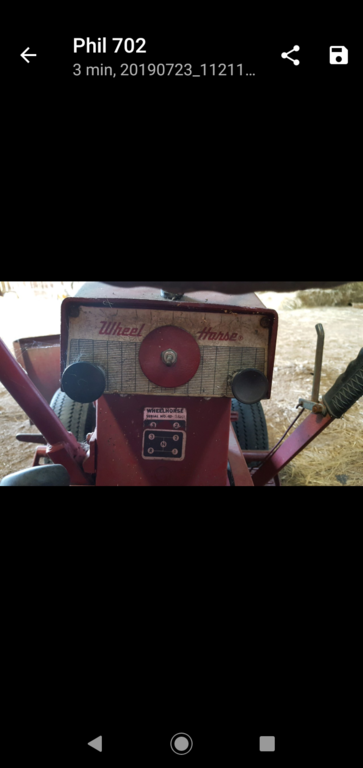

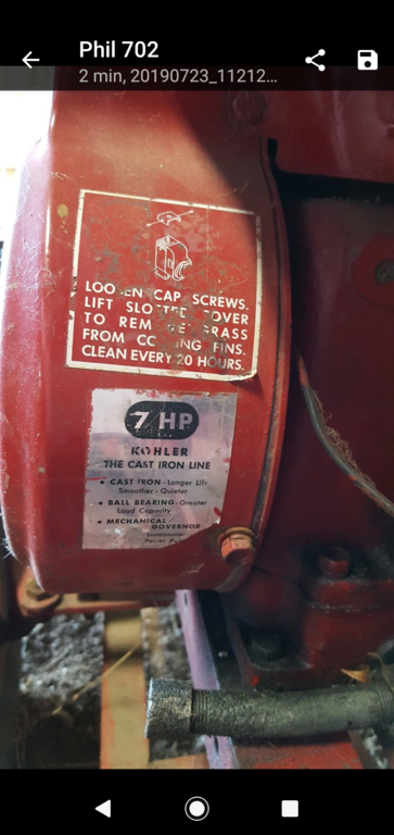

mhlmeader 689 #14 Posted July 23, 2019 Here's some more pics... Share this post Link to post Share on other sites
stevasaurus 23,843 #15 Posted July 23, 2019 Finally, a correct 702!!! Everyone has always wondered about the "0" and the "5" as the second digit. The 502 was a pull start, the 702 was a pull start, the 552 is electric start and the 752 is electric start. The planets have finally come into alignment. You would think that a pull start 702 would have come with the tool box like this 502 did. The thread tractor does have the correct 702 seat. It has been re-painted. It has original tires, front & rear. The tower looks correct for the pull start. It looks like a real 702. 2 Share this post Link to post Share on other sites
buckrancher 2,697 #16 Posted July 23, 2019 1 hour ago, mhlmeader said: Here's some more pics... something odd is going on here I have never seen a old original kohler 7hp with a 7hp decal like that on the side of the blower tin 4 Share this post Link to post Share on other sites

Terry M-(Moderator) 2,322 #21 Posted July 24, 2019 7 hours ago, buckrancher said: something odd is going on here I have never seen a old original kohler 7hp with a 7hp decal like that on the side of the blower tin looks like this engine may have been painted.... along with the tractor too. Hard to say what this tractor really is..... 1 Share this post Link to post Share on other sites
