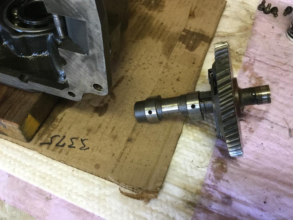

rmaynard 17,642 #2 Posted July 22, 2019 Are you turning the flywheel in the correct direction? There is only one "S" mark. The other is top dead center. I've seen a cam shaft break, but never slip. 2 Share this post Link to post Share on other sites

richmondred01 2,393 #7 Posted July 23, 2019 (edited) Cams break they don’t slip. Check your point gap. Replace if required with Kohler points. As already stated the timing is set by the points. Also, the timing may be off if the flywheel key has sheered. Edited July 23, 2019 by richmondred01 Share this post Link to post Share on other sites

rmaynard 17,642 #11 Posted July 23, 2019 12 hours ago, troutbum63 said: What would cause a cam to brake outside of flawed material or poor machining? The only cam that I ever saw break was in a K-91 engine that broke a connecting rod. Before the rod came through the side of the crankcase, it must have hit the cam gear/shaft and cracked it where the shaft and gear meet. The owner of the engine told me that after the crankcase was welded and the rod replaced, it didn't take but less than an hour for the camshaft to separate from the gear. There was a clunking noise, and the engine stopped dead. Share this post Link to post Share on other sites
