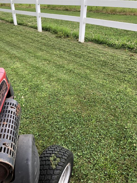

H_ALLEMANG 5 #1 Posted July 22, 2019 Hi all. I’ve been trying to figure out why I’m getting those little lines in the middle of my cut, I have a 42” side discharge on a 96 314. Just on both sides of the center blade pretty much. It looks like it cuts even besides those high lines it leaves, I did just purchase new blades. I have also inspected the deck and there seems to be no damage/bending of anything. Has anyone else had this problem? Share this post Link to post Share on other sites

peter lena 10,016 #3 Posted July 22, 2019 agree with oliver2-44, on possible backwards blades, also are you cutting at the highest setting ? looks like your discharge is so dense, ( from a low cut ) that it cannot clear out itself to a easier discharge flow. with the amount of grass that you have, you can find an uncut area and experiment with a setting that is easier to cut and no build up discharge, also watch your cutting speed , slowing it down makes for a more thorough cut and finer discharge, like low range , high gear , pete 1 Share this post Link to post Share on other sites

tunahead72 2,645 #5 Posted July 22, 2019 In addition to what these fine gentlemen have already suggested, try the highest notch on your adjustment lever and see if that makes a difference. You may also be able to raise the deck to the "transport" position and mow there; that's not generally recommended because it can theoretically cause excessive wear to the mower deck hardware, but I've been doing it for decades with no ill effects that I know of yet. Also, is that clover I'm seeing in your lawn? My own personal experience is that clover takes more horsepower to cut well, slowing down and mowing higher seems to help. Share this post Link to post Share on other sites
pfrederi 21,051 #6 Posted July 22, 2019 Take the deck off flip it over and line up the blades end to end and see if the tips are the same heights (level with each other). 42" decks do not have the triangular reinforcing plate that 48's do. Hence the deck shell can bend at a spindle mounting hole a bit meaning your blades are not aligned with each other. Share this post Link to post Share on other sites

Guest 88vic #11 Posted July 23, 2019 Youll want to check the pitch of the cut, that would be front to back. The front of the deck needs to be 1/8 inch to no more than 1/4 inch lower than the rear. You check this with the middle blade at the tips, not the housing. I apologize if this isnt clear, let me know if you have any questions, Brady. Share this post Link to post Share on other sites

H_ALLEMANG 5 #14 Posted July 23, 2019 5 hours ago, WHEELHORSEFAN*16 said: Youll want to check the pitch of the cut, that would be front to back. The front of the deck needs to be 1/8 inch to no more than 1/4 inch lower than the rear. You check this with the middle blade at the tips, not the housing. I apologize if this isnt clear, let me know if you have any questions, Brady. Could you explain a little more please? I just ran the rear discharge and it cuts even worse. The middle cuts lower than the sides and I even removed the washer under the blade. I noticed on my SD that there’s an adjustment rod on the rear where the level wheels are, would that be how I adjust it for the measurements you were asking I take? The brand new blades are fairly level with one another, no spacers under them either. Share this post Link to post Share on other sites
Marv 996 #15 Posted July 23, 2019 1 hour ago, H_ALLEMANG said: Could you explain a little more please? I just ran the rear discharge and it cuts even worse. The middle cuts lower than the sides and I even removed the washer under the blade. I noticed on my SD that there’s an adjustment rod on the rear where the level wheels are, would that be how I adjust it for the measurements you were asking I take? The brand new blades are fairly level with one another, no spacers under them either. That adjustment rod is used to adjust front to rear height. with unit on level area, hard surface preferred, set the height adjustment in center notch or higher. Adjust the rod so the blade tip (front end with blades pointing forward and aft) so the front is 1/8 to 1/4" lower than the rear. I have also done it by using a level on top of the deck housing, worked for me. That's because I am old and stiff. Marv 1 Share this post Link to post Share on other sites

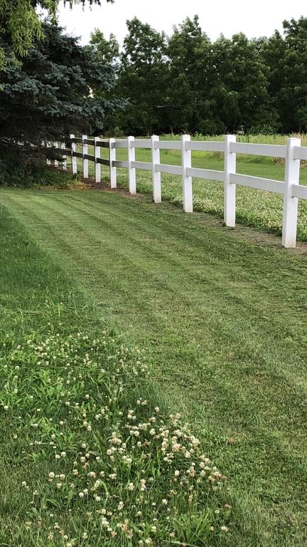

H_ALLEMANG 5 #24 Posted July 28, 2019 *UPDATE* I finally had the time to mess with it again and I used the method that Marv suggested, I used a level on the deck. The adjustment rod was way down so I adjusted it up to level and now she cuts great!! 1 Share this post Link to post Share on other sites
