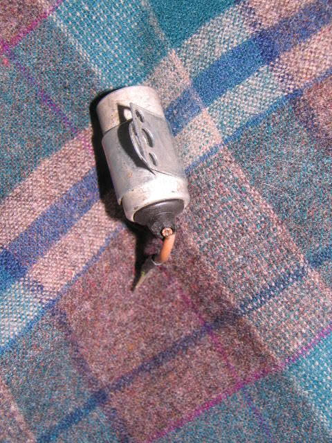

wallfish 20,576 #3 Posted July 22, 2019 Smoking consistently isn't seafoam as it burns clean. Black smoke is extra fuel, white smoke is oil burning A black soot spark plug is an indication it's running rich. Most of the time those chinese carbs fire right up and only need minimal adjustment. Not sure why your coil is in the way of any adjustment and you can probably thank the previous owner for moving it in the way Spin the engine by hand and you will see the points open/close. There's a small rod which rides on a camshaft lobe. Search "static timing" as the points gap is what adjusts timing My first guess would be a bad condenser. But I have also had issues with new chinese carbs flooding out with no apparent reason why. 2 1 Share this post Link to post Share on other sites
oldredrider 2,553 #4 Posted July 22, 2019 I agree with @wallfish on this. A bad condenser is the probable cause. Cheap to replace. Make sure it is grounded well and connected to neg. side on the coil. 1 Share this post Link to post Share on other sites
pfrederi 21,146 #5 Posted July 22, 2019 Quick easy test. Disconnect your condenser and see if things improve.... 1 1 Share this post Link to post Share on other sites
pacer 3,180 #6 Posted July 22, 2019 Your description does indeed sound like a possible condenser problem. Couple months ago I had an Onan giving very similar symptoms as you describe - had pulled the points/condenser twice and other than cleaning they looked fine. After much frustration I decided to once again go thru the common steps to correct the surging - adjust carb/ck wiring/ck fuel and ignition, etc. Had again pulled the points/cond and again looked fine --- but on re-installation I happened to see what looked like a crack in the condensers wire insulation so pulled it back out and gave a closer look see.... See the picture, thats the crack after I bent the wire!!! it was almost invisible at first, but definitely was letting the magic electrons leak out. I let out a loud WHOOPEE! and went and scrounged another condenser and --- oh yeah, that Onan purred like a kitten!! 2 1 Share this post Link to post Share on other sites
giantsean 62 #7 Posted July 22, 2019 Soooooooo... I gapped the plug to .35. No change. BTW the condenser is wired correctly but it was held to the painted coil with a zip tie. Not sure how I didn't notice that before lol. As I was looking through the pile of "old" parts he gave me w/ the rig, including points, condenser, and coil... my mind started to go back to him telling me that it "used to run perfect" which made me wonder... maybe he tuned it up with bag of sh*t parts. I put the "old" condenser back on to the negative pole and slipped it between a metal clip (really not the best ground but whatever). Fired up almost immediately and shot a column of flame out of the carb. That's different! It certainly ran a LOT better in this admittedly poor configuration before the spark show that was the condenser arcing across the metal shield to the head ruined my fun lol. I am going to put back the old coil and put condenser in the right place and see what's what. I think we found the problem though... good thing I destroyed the old carb in the process :P. More to come! 1 Share this post Link to post Share on other sites

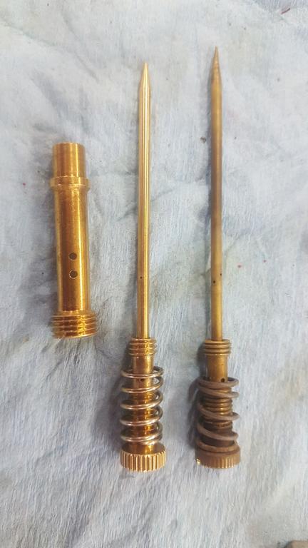

giantsean 62 #24 Posted July 23, 2019 It will stumble a bit more and then die, in both directions. It actually will not idle at all now (since the condenser fix / carb swap) So was fiddling a bit and decided to compare old and new high speed needles and the jet (I only have the China jet though as the OEM was destroyed during extraction. China needle is shorter with less, and smaller holes. I'll see how the $13 one looks when it comes tomorrow. Either way from my limited understanding, more holes = more fuel which is not what I need right now. Is it odd that the governor arm seems to not be pulling at all at this point? Or is it because the revs are too low. I assume it's not making a difference at the moment as the engine runs the same with the rod disconnected. Share this post Link to post Share on other sites
pfrederi 21,146 #25 Posted July 23, 2019 While you wait it wouldn't hurt anything to readjust the float. you have it at the Kohler spec 11/64" and your carb is drowning...so change it to 3/8" or even 1/2" and see if anything changes. (I use drill bits to measure the setting) 1 Share this post Link to post Share on other sites
