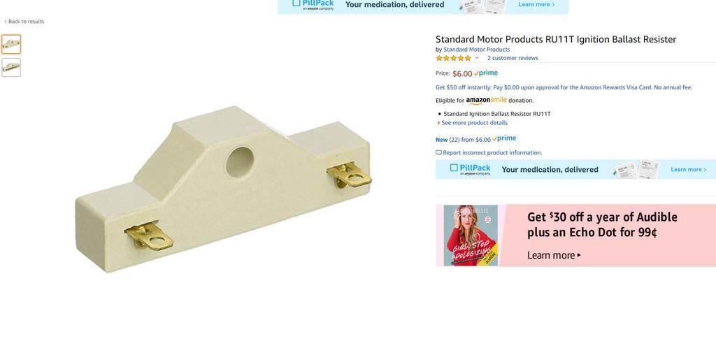

pfrederi 21,300 #12 Posted July 22, 2019 This would work Share this post Link to post Share on other sites
seven 202 #13 Posted July 22, 2019 Ok looks just the one my dad put ion the fatmsllM when he converted it to 12 volts thxs Share this post Link to post Share on other sites
