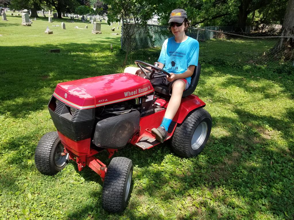

Jpbugeye 3 #1 Posted July 20, 2019 Hi guys, I recently got a 417a wheel horse that starts hard but runs well when started and runs poorly with the lights on and won't start after shutting off when it had been running..I am thinking the coil may be going , any other ideas? Jamie Share this post Link to post Share on other sites
pfrederi 21,183 #2 Posted July 20, 2019 Have you checked you voltage while running??? Adding headlights to the electrical load may drop your voltage enough to interfere with the spark. Before you buy a coil test it. Between the small + and - terminals on the coil you should read 4-5 ohms. Between the two high tension terminals 9500-11500 ohms Share this post Link to post Share on other sites
Jpbugeye 3 #3 Posted July 20, 2019 Thanks for the reply, I can test it soon..I thought the fact that it won't restart when coil is hot and hard starting when cold also suggested a weak spark. Share this post Link to post Share on other sites
pfrederi 21,183 #4 Posted July 20, 2019 38 minutes ago, Jpbugeye said: Thanks for the reply, I can test it soon..I thought the fact that it won't restart when coil is hot and hard starting when cold also suggested a weak spark. It may be a bad coil. Brace yourself if you have to buy a new one... Check out this thread about using a coil from a Harley Davidson....much cheaper Share this post Link to post Share on other sites
