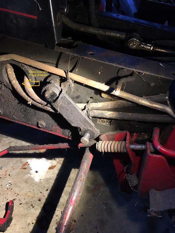

Tgalo 128 #1 Posted July 19, 2019 Wasn't really sure where to ask this so I put it here. Picked up a 520H and the guy had disconnected the lift cylinder and ran two lines to the back of the tractor to run some kind of implement. I want to put it back to the way it belongs. Do I just run the lines back to the cylinder? He gave the old lines that came off. Took a picture of it. I've got to clean it up I know... Thanks, Tony Share this post Link to post Share on other sites
WVHillbilly520H 10,378 #2 Posted July 19, 2019 1 hour ago, Tgalo said: Wasn't really sure where to ask this so I put it here. Picked up a 520H and the guy had disconnected the lift cylinder and ran two lines to the back of the tractor to run some kind of implement. I want to put it back to the way it belongs. Do I just run the lines back to the cylinder? He gave the old lines that came off. Took a picture of it. I've got to clean it up I know... Thanks, Tony What would be cool if he would have added an extra spool valve then you could run the lift cylinder and the rear whatever also... To answer your question yes just put the lines back to the cylinder... Share this post Link to post Share on other sites

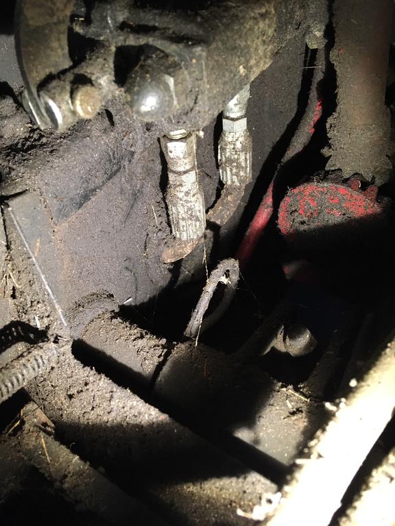

Tgalo 128 #5 Posted July 20, 2019 (edited) Looks like he had a 3 point hitch and the lines were for up and down I guess. What sucks is they left the cylinder ports open and now their filled with crud. I power washed it and now I can see. Edited July 20, 2019 by Tgalo Share this post Link to post Share on other sites
