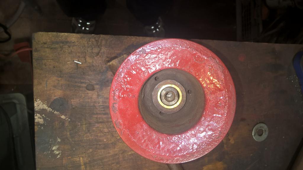

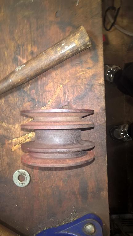

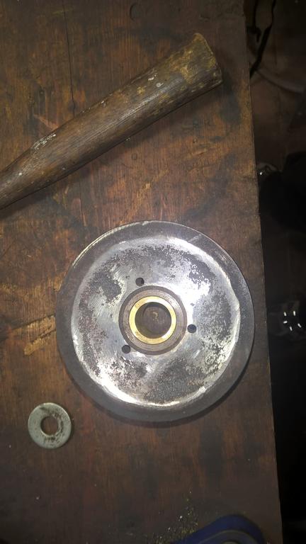

drewd 55 #1 Posted July 19, 2019 Hi All, I am hoping to convert my cast iron double d center pulley to work with the 3/4" shafts. I had the pulley milled and fitted with a bronze bushing. The fit is great and still fits nicely on the double d spindle I have. TOP pic shows pulley on dd spindle. The issue is the bottom of the pulley. It has no short collar as the new round shaft pullies do. I was thinking of putting on a blade spacer just below the pulley to clear the spindle rim. The blade space would sit right on the spacer seal like an extension. Has anyone tried this? Has it worked? Thanks! Share this post Link to post Share on other sites

drewd 55 #6 Posted July 21, 2019 Well, I have the converted double D pulley on the deck. I trimmed a 3/4 washer to fit the indent in the bottom of the cast iron pulley that allows the pulley to clear the spindle housing. I'll give it a try as soon as I figure out the belt tensioner. Here is a pic of the deck with center pulley. I'll post a separate question on the tensioner issue. Share this post Link to post Share on other sites
