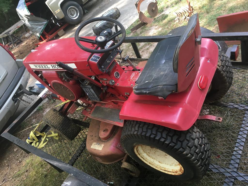

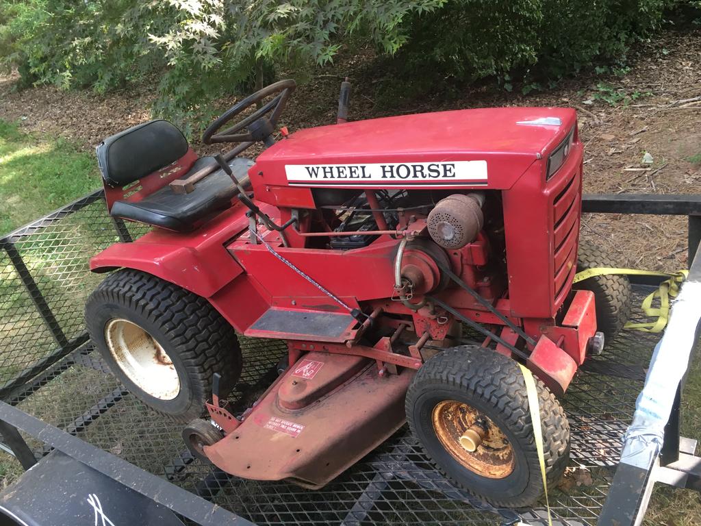

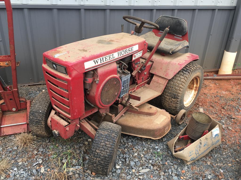

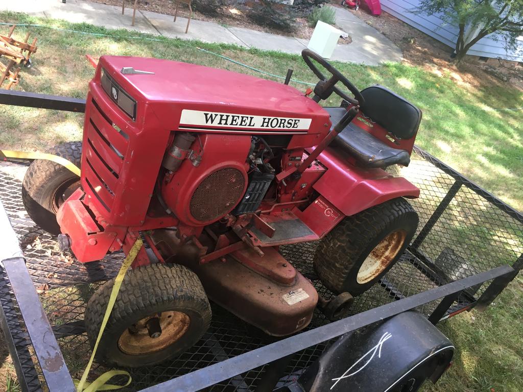

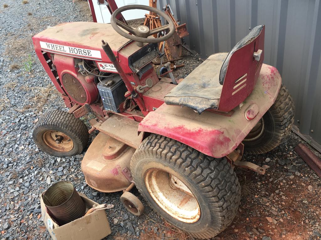

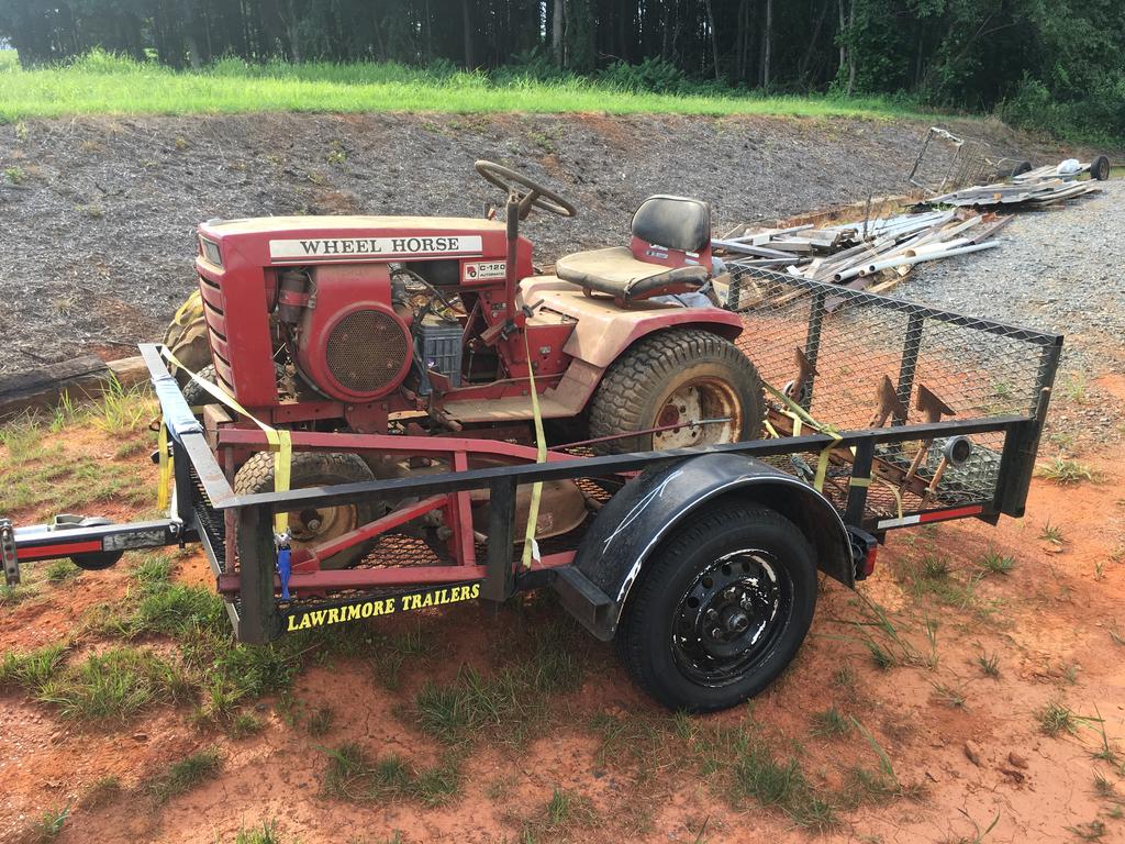

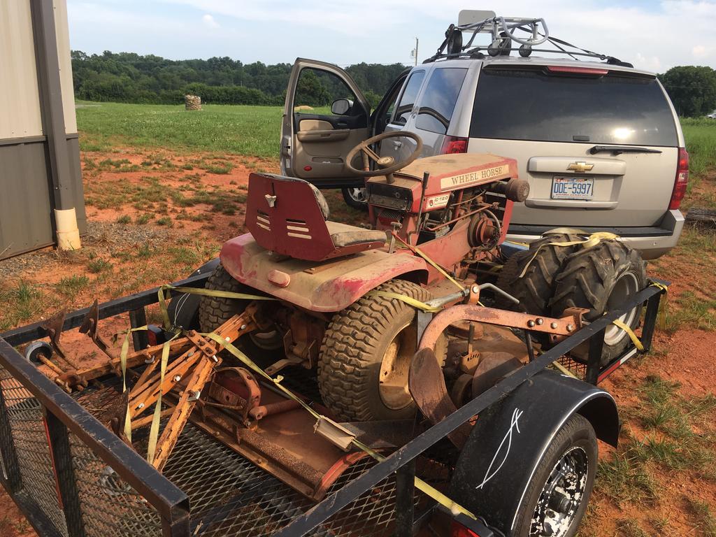

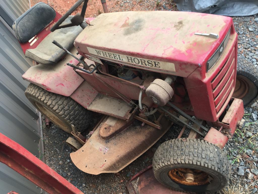

Jrblanke 918 #1 Posted July 17, 2019 Well, I wasn't planning on this purchase, but the listing was relatively close, and I thought it would be a quick fun project. I was also thinking it might be a good machine to leave up on some property to cut grass with once or twice a month. It came with an extra set of ag tires, wheel weights, a brinly cultivator, brinly moldboard plow, and snow plow. The 42" SD deck had new spindles put on it that are the newer style, so I'm pretty excited about that. I was excited to get it home and see what was under all that dirt! So I got the pressure washer out, and washed the dirt off. I accidentally blew the C120 stickers off with the pressure washer, but I contacted @Vinylguy and he is going to hook me up. It looks like a nice machine! It was repainted once before, but they didn't do a bad job. The new china carb should be here on Friday, so once it arrives, i'll start messing with it. I can't wait to hear it run! I included pictures of it sitting at the previous owners house, loaded up on the trailer, and after it was pressure washed. 15 13 Share this post Link to post Share on other sites

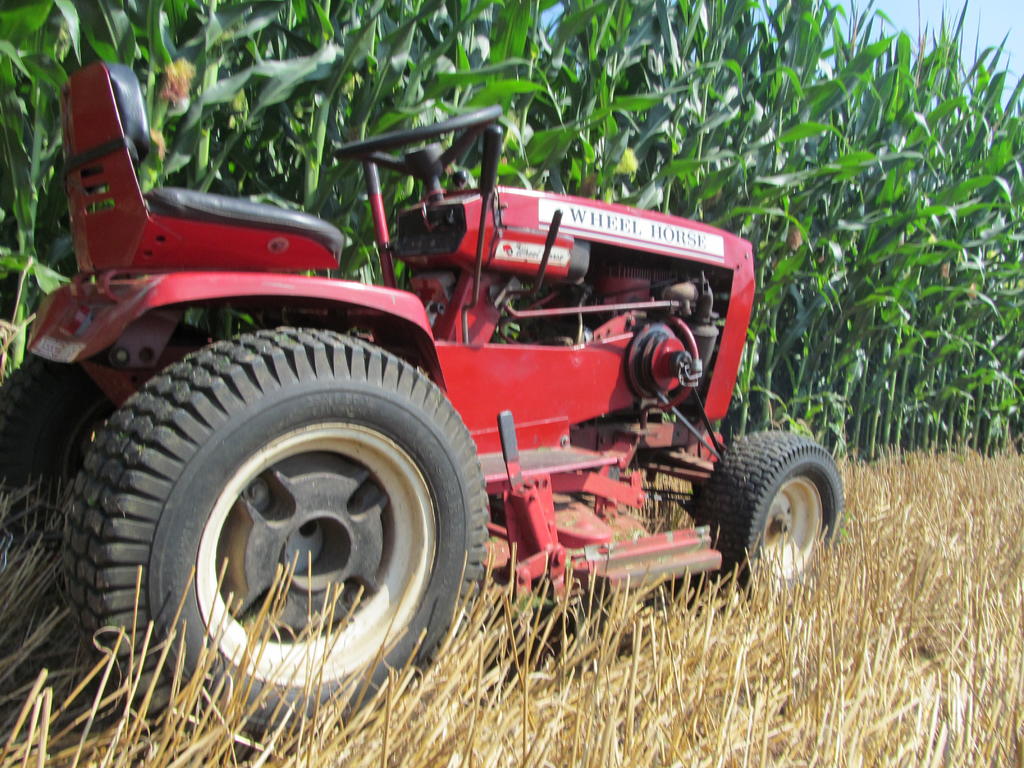

Ed Kennell 43,842 #13 Posted July 18, 2019 Congrats James. Really nice 120 auto. and well equipped. My 120 auto was my first WH and after buying and selling 50+ tractors, I still have the 120. Mine has the Tecky HH120, but it has been trouble free and always starts and runs strong. 6 1 2 Share this post Link to post Share on other sites

Jrblanke 918 #21 Posted July 18, 2019 3 hours ago, Ed Kennell said: Congrats James. Really nice 120 auto. and well equipped. My 120 auto was my first WH and after buying and selling 50+ tractors, I still have the 120. Mine has the Tecky HH120, but it has been trouble free and always starts and runs strong. I love that top picture!! 2 1 Share this post Link to post Share on other sites

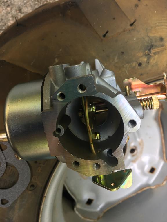

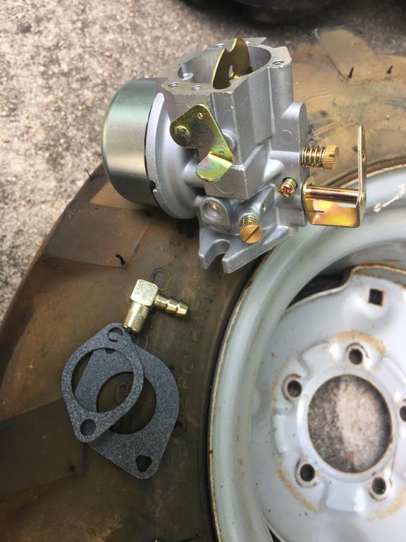

Jrblanke 918 #22 Posted July 20, 2019 Carb came in and I was so excited I cross threaded the fuel inlet (1st thread) Fortunately i had a tap that cleaned up the threads. I put it on, filled up the gas tank, and cleaned the points, but it still didn’t fire it up. I think I have a weak spark and no fuel. Next step is going to be to clean all the connections to make sure I get a good spark (currently I have some spark but it’s intermittent and inconsistent). I’ll also put on a new fuel line and filter. Hopefully the pump will work. That is yet to be seen. Here are a couple pics of the carb. 1 Share this post Link to post Share on other sites

Jrblanke 918 #25 Posted August 15, 2019 Here is the update: If you have followed my thread in the electrical section, you know I had a little hickup with the solenoid. I've gotten that straight, and the tractor runs! Woo hoo! The problem I am having now is that it is running WAY to rich at wide open throttle, and it also will not idle. I have adjusted the mixture screws all the way closed at WOT and it will not cut off the machine. Before I purchase new points and condenser, I'm going to clean the OLD carb and put it back on to see if that will make it run better. Not impressed with the china carb so far. 2 Share this post Link to post Share on other sites
