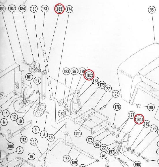

rmaynard 17,644 #1 Posted July 17, 2019 (edited) My new 875 runs great, but I would like to upgrade some of the motion control parts. I have posted a "wanted" ad, but thought I would just add my issue here. The following parts are worn. If I can't find ones in better condition, does anyone have any ideas on how to make them better? Item 185 is egg shaped at the 1/2" top hole. Item 182 is worn at all locations where it contacts the bushings. FOUND GOOD ONE Item 194 is worn both on the inside and has a groove on the top. FOUND GOOD ONE I know there are those who will say "weld it and machine it", but I neither weld nor machine. If there is anyone who has any other ideas, let me know. Thanks for any advice. Edited July 19, 2019 by rmaynard Share this post Link to post Share on other sites
RandyLittrell 3,946 #2 Posted July 17, 2019 I think this may work for you if you don't find some better parts. I used to work on a sprint car and we used jp weld on stuff I didn't think would work, but it did. https://www.jbweld.com/collections/metal/products/steelstik-epoxy-putty-stick Randy 1 Share this post Link to post Share on other sites

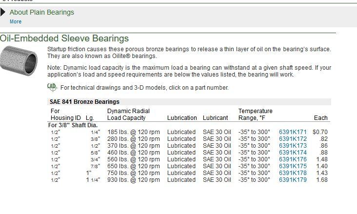

pfrederi 21,308 #3 Posted July 17, 2019 Most of the holes are 3/8" get some 1/2 " sleeve bearings form mcMaster drill it out and put in the sleeve. 1 Share this post Link to post Share on other sites
