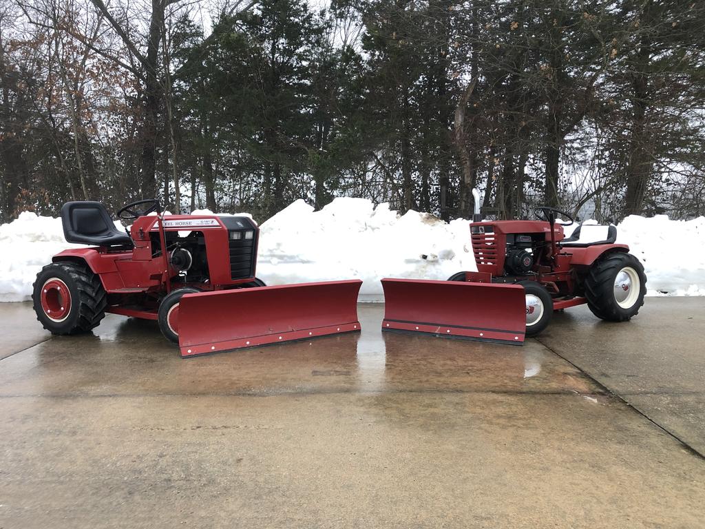

wh500special 2,465 #12 Posted July 18, 2019 When I lived in snow country and had a 300' driveway I would do like many of the other guys; run down the middle first then make successive lengthwise passes widening the cleared path with each stroke. If it was a really deep or wet snow I might have to plow across the driveway to both sides to move it, but that was pretty unusual. And I pushed the snow as far off as was practical to make room for more snow - and drifting - the rest of the winter. It only happened once, but it was enough to have me change my pattern though... About half way through one winter we had a monster snowstorm and it was cold and windy. Like -15 F and 50 mph winds. My driveway ran largely East to West and the NW wind deposited 10 acre's worth of snowfall in my driveway due to the previously plowed snow on the north side of the driveway making a perfect wind break for catching drifts. It was a mess. After that big one, I started pushing the whole driveway's worth of snow to the south side of the driveway to avoid creating a snow fence on the (prevailing) upwind side. Granted, this was Indiana prairie where the wind really howls with very little to interrupt it so you may not have the same problems. Don't go bigger than a 42" blade on that tractor. You'll probably find the front end doesn't weigh enough on its own to keep from skidding sideways with a heavy angled blade full of snow. It's 94 here with 65% humidity today...hard to think about snow. Steve Share this post Link to post Share on other sites

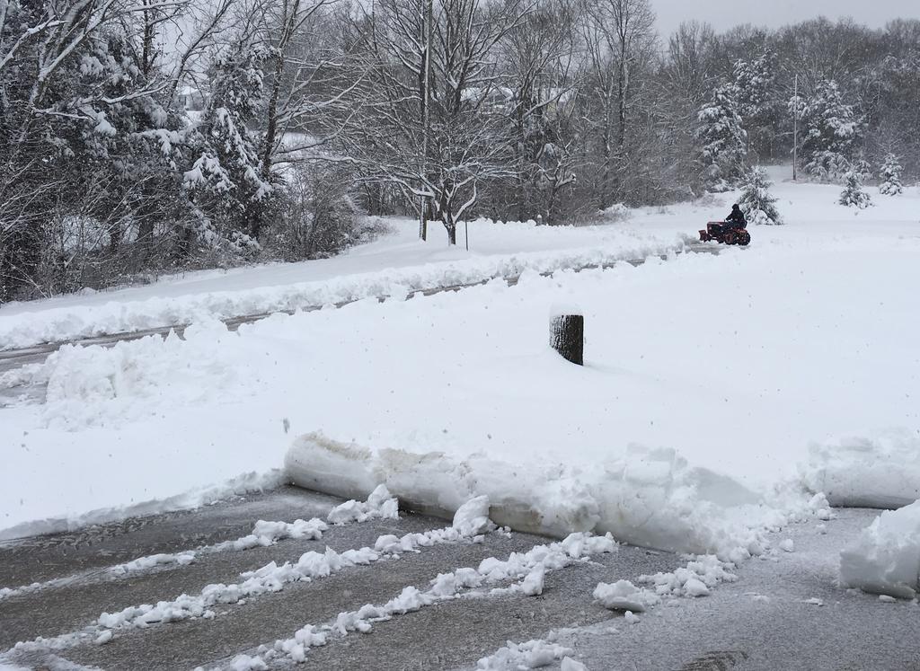

PeacemakerJack 11,061 #15 Posted July 19, 2019 It is really funny to be talking about this topic on what is likely to be the hottest day so far this year in East Central WI! I echo the sentiments above. I am fortunate to have to snow machine for my 250’ of driveway. I use my Cub with a 60” Haban blade for anything under 6” or the wet heavy slop. It is imperative to push back about 20’ further than you think if you live in an area where you could get a lot of snow over the winter without a warm up melting period in between snowfalls. In this particular video, I didn’t have my suitcase weights on the back which add about 200# of ballast. I am running 2-link v-bar chains because I have a gravel drive. You will notice as I get deep into the push that I am picking up some wheel spin. We were on our way into town and I wanted to get things cleared out. It was a balmy 30 degrees when the video was taken and I’m not even wearing a hat—what’s the deal? That Cub weights about 1250# with the plow but without additional weight. It handles the snow good to a point. When it gets deep, this is my go to machine... You’ll notice that the drift behind my truck is as tall as the 24” blower and it does a great job of getting the snow out of the area as it will toss it an easy 60-70’ working with the wind. If you have a place to push the snow back to, the blade will be fine. I always go down the center of my drive first with a straight blade orientation, then I angle it to a side and widen out to the appropriate width—usually about three times the width of the drive for the first snow. Up by the garage, I take a back and forth approach because it is 60’x40’. No real good way to do that other than push it out one blade at a time. Good luck! 1 Share this post Link to post Share on other sites

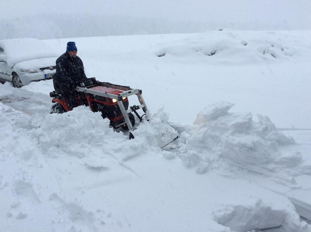

lynnmor 9,042 #20 Posted July 20, 2019 Where would I plow this snow? Share this post Link to post Share on other sites

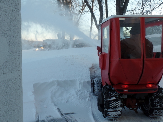

Herder 2,356 #23 Posted July 20, 2019 (edited) On 7/17/2019 at 10:22 AM, ebinmaine said: Probably not the answer you were really looking for but, D. All of the above. Your biggest issue is going to be Traction. You'll have plenty of power. You're going to want to get weights, fluid or steel or both. Chains made of either steel or rubber depending on how you feel about your driveway. As mentioned by EB - fluid, weights and chains. Two link chains give better traction but may cause damage to your blacktop driveway. This Raider has all the above and will push practically anything. It's great for snow removal. The difference is my driveway is capped with stone dust and when frozen helps to improve traction. I found that this type of front tire helped a lot in the snow. Edited July 20, 2019 by Herder 4 Share this post Link to post Share on other sites
