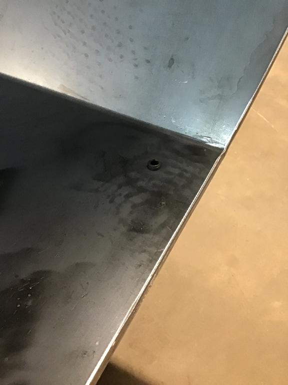

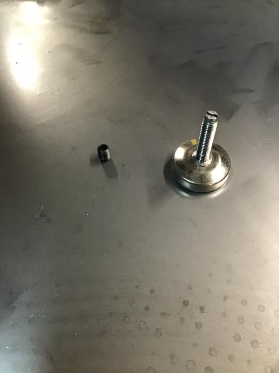

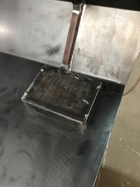

Pullstart 71,567 #103 Posted August 12, 2019 Final inspection day! He’ll be here in an hour and hasn’t yet seen it in person! We did a design change on the legs, to keep it as close to the ground as possible. I’ll cut some 1/8” plate to place under the set screws, to push against the carpet floor. 2 2 Share this post Link to post Share on other sites
953 nut 70,664 #104 Posted August 12, 2019 1 hour ago, pullstart said: We did a design change on the legs, to keep it as close to the ground as possible I think I would use a hex head cap screw, unless the floor is perfectly level you will need some adjustment. Share this post Link to post Share on other sites
Pullstart 71,567 #105 Posted August 12, 2019 The set screws are 1/2” long and should allow for an 1/8” to 1/4” adjustment and still support the assembly... I hope! Share this post Link to post Share on other sites

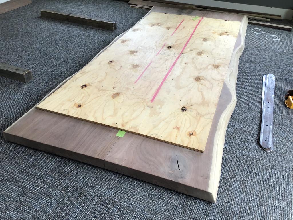

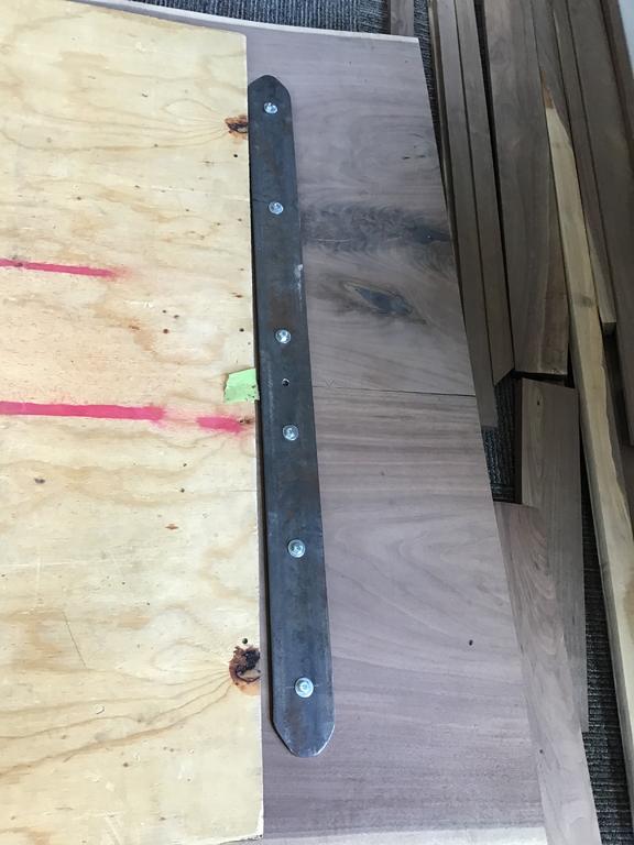

Pullstart 71,567 #111 Posted August 14, 2019 Sneak peak of the slab! This was my first glimpse of the rest of the story! I built some quick straps to help prevent cupping and separating on the ends of the seam and used the threaded inserts to hold one end down for now. 4 1 1 2 Share this post Link to post Share on other sites
Tractorhead 9,218 #112 Posted August 15, 2019 Whow, buddy what a cool lookin. A big advantage is, a theft protection is maybe not needed, because of weight.. 😂👍 How you like to protect the Surface ? Using Oil, Wax or Clearcoat? Share this post Link to post Share on other sites

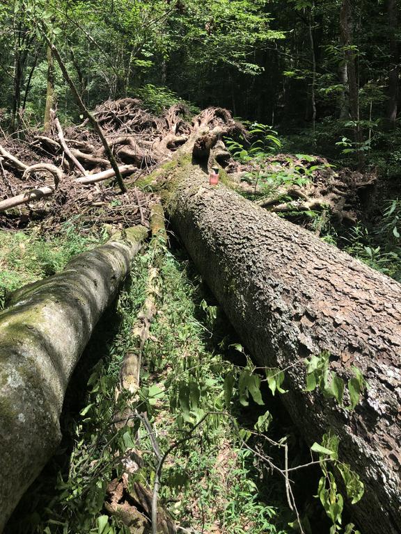

The Tuul Crib 7,354 #119 Posted August 31, 2019 Nice lookin slab! It all turned out great ! So whats the next project? I have a nice 3 foot diameter sycamore tree that fell during the last storm we had! If you look closely you can see a black and tan on tap! I mean on top! 3 1 Share this post Link to post Share on other sites
