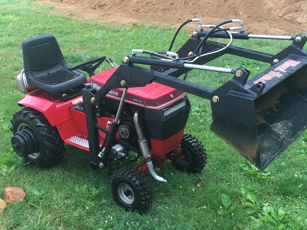

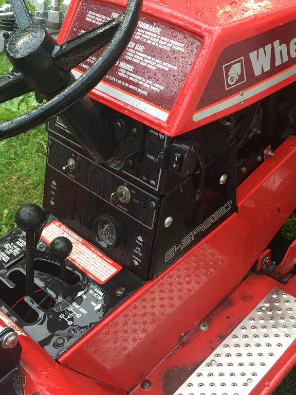

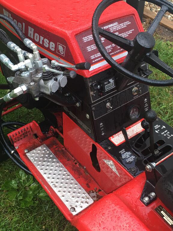

KrazeyOlDave 860 #37 Posted July 5, 2020 C160 direct bolt in on a 1986 310-8? Mine just puked and I need something stroooonggg,lol. It’s a FEL and will see lots of abuse. Share this post Link to post Share on other sites
Pullstart 70,564 #38 Posted July 5, 2020 Yes, any 8 speed @KrazeyOlDave . I mentioned Dave Mercer in hour bucket tractor build thread. He might have something he’s gone through sitting there waiting. 1 Share this post Link to post Share on other sites
