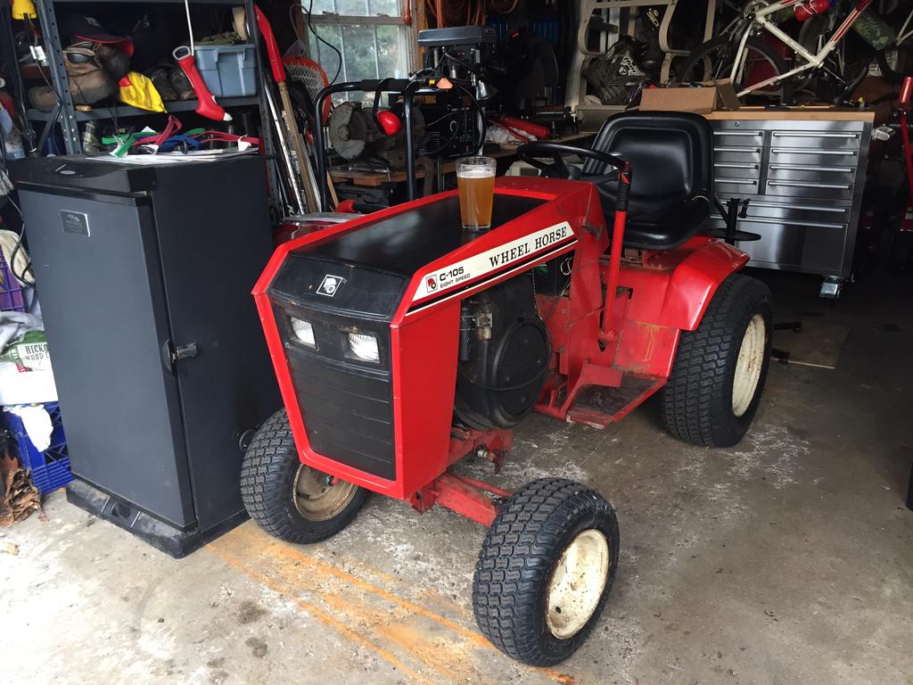

SylvanLakeWH 30,481 #7 Posted July 16, 2019 My C105 welcomes a cousin to !!! Love the Black Hoods!!! 1 1 Share this post Link to post Share on other sites

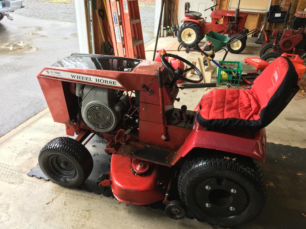

Sparky-(Admin) 24,542 #8 Posted July 16, 2019 Mine isn’t as pretty as the one pictured above, but’s its a great worker! (She ain’t shiny, tractors wet in the pic) 3 Share this post Link to post Share on other sites
AHS 1,591 #9 Posted July 16, 2019 Love the beer on the hood!!👍 ok, I will check the bore, and adjust the valves. Great info on here! Thank you guys!! 2 Share this post Link to post Share on other sites
The Tuul Crib 7,340 #10 Posted July 16, 2019 1 hour ago, SylvanLakeWH said: My C105 welcomes a cousin to !!! Love the Black Hoods!!! Better finish that beer before it heats up! 1 1 1 Share this post Link to post Share on other sites
