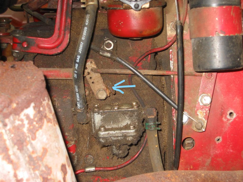

pfrederi 20,657 #3 Posted July 15, 2019 (edited) The high speed limit is the bar stop sticking out (Blue arrow). Loosen the bot and rotate the bar stop slightly counter clockwise to lower the top end speed. A bit dirty was the only pic I could find on short notice. Edited July 15, 2019 by pfrederi 2 Share this post Link to post Share on other sites

pfrederi 20,657 #8 Posted July 16, 2019 All engines are slightly different but your high speed limit seems to be set much further over than any of mine. It is a very sensitive setting a small movement makes a significant speed change at top end. The top edge of yours is about 3 o'clock most of mine are around 1 or 2 o'clock 1 Share this post Link to post Share on other sites
moe1965 774 #9 Posted July 16, 2019 Not sure which which pix is the high speed limit Share this post Link to post Share on other sites
pfrederi 20,657 #10 Posted July 16, 2019 see my picture up this thread with the blue arrow 1 Share this post Link to post Share on other sites
