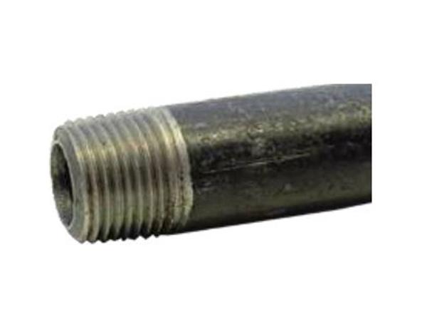

870express 116 #2 Posted July 14, 2019 Never mind. I found it. I guess I just needed to vent. https://www.supplyhouse.com/Bluefin-BLN050-350-1-2-x-3-1-2-Black-Nipple Carry on. 1 Share this post Link to post Share on other sites

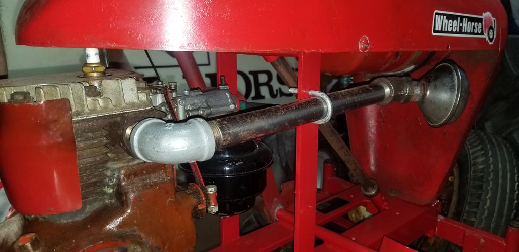

870express 116 #9 Posted July 14, 2019 (edited) 1 hour ago, AMC RULES said: What are you using the 3.5" length for? My RJ59 has a Clinton B1290 engine and the first section of pipe coming out of the exhaust port requires exactly 3-1/2 inches to clear the frame. This photo shows the setup using a 3-inch section of pipe, which is too short, and the elbow is not tight. Edited July 14, 2019 by 870express Share this post Link to post Share on other sites
adsm08 5,231 #10 Posted July 14, 2019 1 hour ago, 870express said: My RJ59 has a Clinton B1290 engine and the first section of pipe coming out of the exhaust port requires exactly 3-1/2 inches to clear the frame. This photo shows the setup using a 3-inch section of pipe, which is too short, and the elbow is not tight. If you are not copying an old piece make sure you add 1/4-1/2 inch to your measurements for area taken up by thread. 1 Share this post Link to post Share on other sites

870express 116 #12 Posted July 14, 2019 1 hour ago, 71_Bronco said: You can get a 3-1/2" piece, threaded on both ends, from McMaster for $1.62 + shipping. Can also get a 4" (not sure if you've tried 4" or not) I have an account with them for when I need some odd special bolts or whatever. Thanks, but I already ordered one from this place - https://www.supplyhouse.com/Bluefin-BLN050-350-1-2-x-3-1-2-Black-Nipple - last night. $0.84 + shipping. 1 Share this post Link to post Share on other sites
