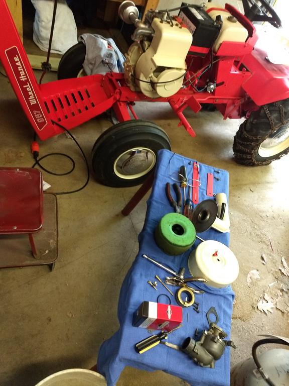

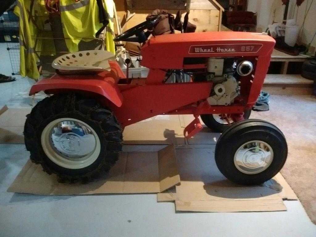

ebinmaine 81,048 #4 Posted July 13, 2019 8 minutes ago, squonk said: 6-12's on the rear and 4-8.00's on the front. That's what I was thinking too. Here's Trina's Pony tractor as a photo example 4 Share this post Link to post Share on other sites
71_Bronco 1,073 #5 Posted July 14, 2019 22 hours ago, ebinmaine said: That's what I was thinking too. Here's Trina's Pony tractor as a photo example Thanks for the pictures, that's what i was thinking for size / looks. I'll take a measurement of my overall width with the current tires. I do know that the hubs are close to the trans axle extensions. 1 Share this post Link to post Share on other sites

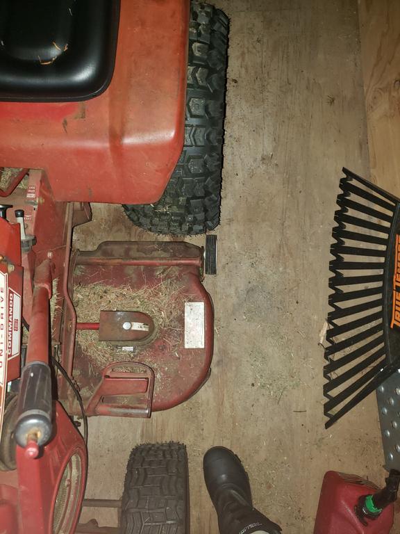

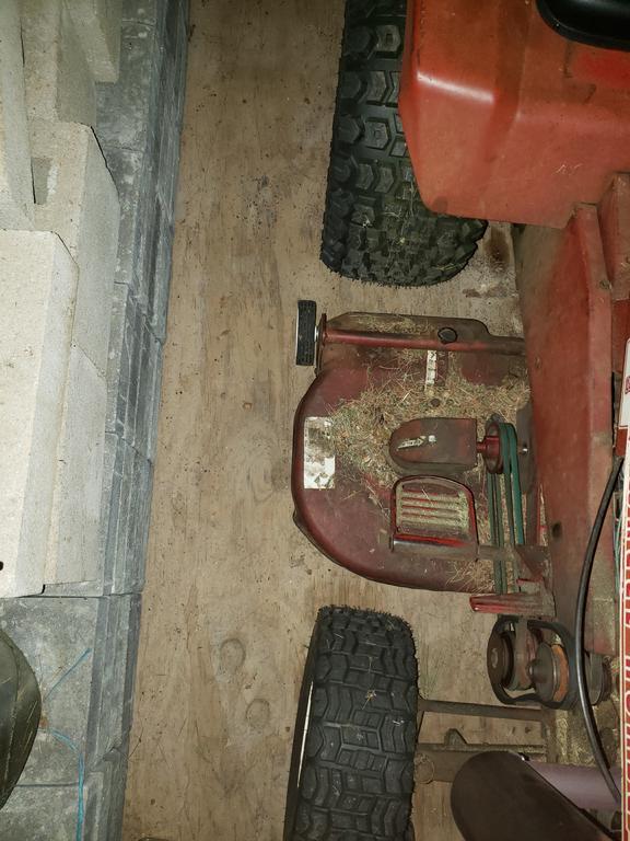

71_Bronco 1,073 #9 Posted July 16, 2019 (edited) Okay, went and looked at it tonight. It almost looks like the width of the tires is the same as the deck, but the deck for some reason looks kicked to one side. Of course, the side I was looking at whilr mowing was the left side, which almost looks like the tires are in line with the deck. I'll also be loosing an inch or so as the deck shell is slightly wider than the actual width of cut. Edited July 16, 2019 by 71_Bronco Share this post Link to post Share on other sites
ebinmaine 81,048 #10 Posted July 16, 2019 Looks about like it should as far as the "set" of the tires. You'd gain some by changing to 6-12s for sure. Can the deck be adjusted side to side? Share this post Link to post Share on other sites
