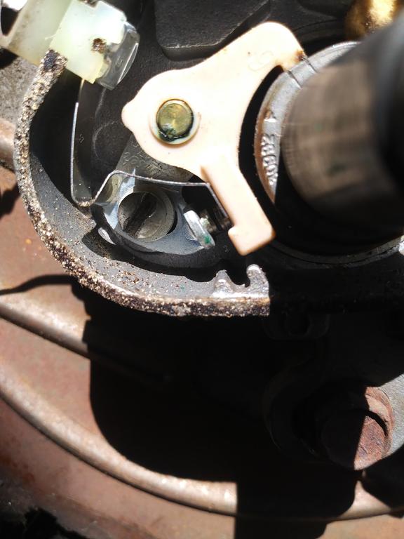

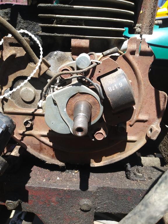

GetEmJohnnyBoy 14 #1 Posted July 13, 2019 (edited) My spark is super weak, no spark on the plug but can feel the pulse with my fingers. How do I test the ignition coil and where can I find ground locations to clean? Never messed with magnetos of this type. Couldn't find one online that looked like it. Edited July 13, 2019 by GetEmJohnnyBoy Share this post Link to post Share on other sites

GetEmJohnnyBoy 14 #4 Posted July 13, 2019 Think I got it Taken care of. Cleaned the points and set to .020. They was pushed together when I took off the cover. Oops. 1 Share this post Link to post Share on other sites
