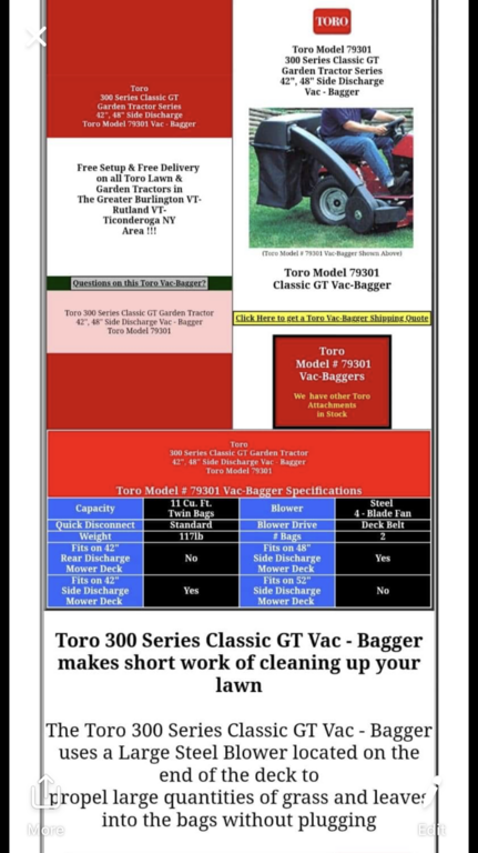

Ritter 38 #1 Posted July 12, 2019 I‘m reaching out to the experts here for some feedback. I have a 1986 WH 312–A. A nice gent is selling a vac bagger. Its a Toro Model 79301 Classic GT bagger I‘m wondering if this will attach to and work on my 312? Deck width is the same. I’ve attached the specs for the Vac Bagger along with a pic of my WH. Any help would be greatly appreciated. Again, just curious to know if it would fit Thanks Share this post Link to post Share on other sites

gwest_ca-(File Mod) 12,360 #5 Posted July 12, 2019 All the files that come up in this link are for the 79301 bagger. The 79-7770 kit is still available from Toro but looks a little rich for all it contains. Maybe you can make up what is required. https://www.wheelhorseforum.com/search/?&q="79301"&type=downloads_file&search_and_or=or&sortby=relevancy The 79-7770 kit https://www.partstree.com/parts/toro/parts/79-7770/ Garry Share this post Link to post Share on other sites
Ritter 38 #6 Posted July 12, 2019 Thanks Garry, Just so I understand... the 79301 bagger will work on my 05-42MSO5 mower but.... in order for it to work, I'd need to purchase or fabricate a kit similar to the 79-7770?? I Share this post Link to post Share on other sites
gwest_ca-(File Mod) 12,360 #7 Posted July 12, 2019 That is what I get from the service bulletin. Your deck is model 05-42MS05 - not O5 - use a zero Garry Share this post Link to post Share on other sites
