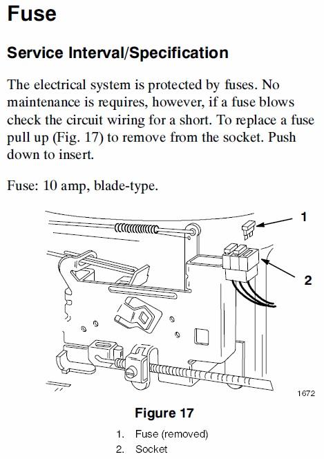

gwest_ca-(File Mod) 12,417 #4 Posted July 12, 2019 Welcome to the forum. Do you have any manuals for your tractor? This is from page 24 of the 2001 operator manual. Looks like they are on the control panel for the throttle and governor on the engine. There is also a service manual Garry Share this post Link to post Share on other sites
