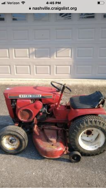

The Tuul Crib 7,354 #1 Posted July 11, 2019 Looking on my local craigslist at this tractor. They have come down in price and I have been watching it. They claim it’s a 1965 with a 48 inch deck but something just doesn’t seem right to me. Share this post Link to post Share on other sites
953 nut 70,345 #2 Posted July 12, 2019 Looks more like a 1967, model 1057. The 1965 was a short frame and couldn't fit a 48" under it. Share this post Link to post Share on other sites
Herder 2,356 #3 Posted July 12, 2019 (edited) The deck looks like a 42". 48s and larger have a reinforcement plate around the spindles that the belt cover bolts to. The pic on the left the deck at the rear of the trailer is a 48" and in the right pic the deck in the front is a 52" both have the reinforcement plate. Edited July 12, 2019 by Herder Share this post Link to post Share on other sites
Retired Wrencher 7,037 #4 Posted July 12, 2019 11 hours ago, 953 nut said: Looks more like a 1967, model 1057. The 1965 was a short frame and couldn't fit a 48" under it. Richard it may be a 1057/1257 but wrong decal or hood was changed. Share this post Link to post Share on other sites
Lee1977 7,809 #5 Posted July 12, 2019 It not a 48" deck the height adjustment is always on the left. There isn't one there it's a 42" deck. Share this post Link to post Share on other sites
