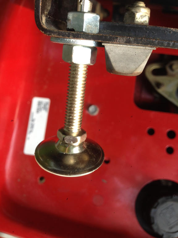

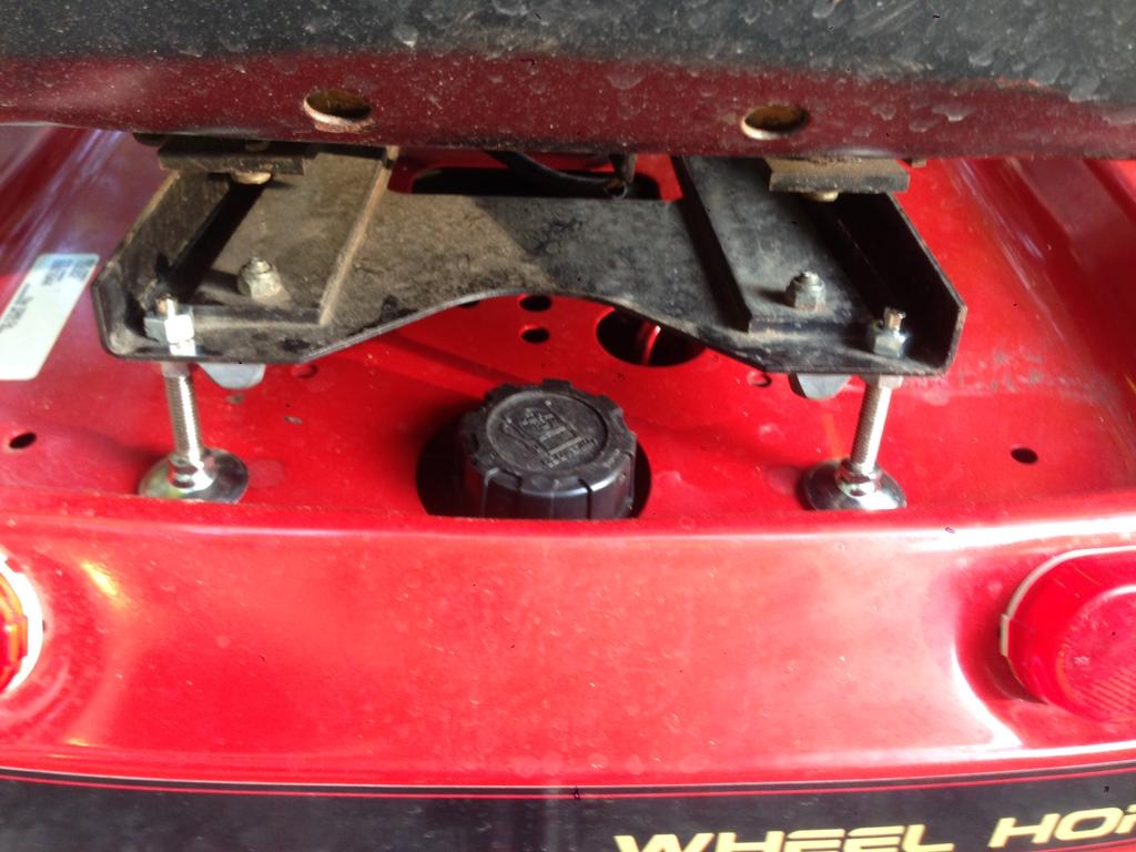

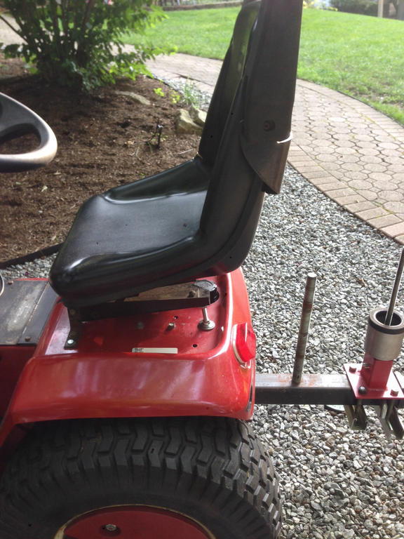

formariz 12,359 #1 Posted July 9, 2019 I always found original seat backrest too reclined , making me to lean forward all the time. Used a couple of heavy duty furniture levelers (plenty of that around here) on the existing holes and it now puts backrest in the perfect position for my back. The slight height gain also makes it more comfortable. 7 Share this post Link to post Share on other sites
WVHillbilly520H 10,378 #2 Posted July 10, 2019 59 minutes ago, formariz said: I always found original seat backrest too reclined , making me to lean forward all the time. Used a couple of heavy duty furniture levelers (plenty of that around here) on the existing holes and it now puts backrest in the perfect position for my back. The slight height gain also makes it more comfortable. Cass, I did something similar on my '95 with red rubber coated bolts, a little more forgiving on the fender paint. 1 Share this post Link to post Share on other sites
formariz 12,359 #3 Posted July 10, 2019 The ones I used have a plastic bottom. I could also put a heavy felt pad on them like the ones used on bottom of chair legs. it is definitely a great improvement in riding comfort. Share this post Link to post Share on other sites
dalez 148 #4 Posted July 10, 2019 Now you started something. It's a great modification. I just did mine after reading this with some 3/8" carriage bolts and put 3/4" rubber chair/cane tips on the bottom. Share this post Link to post Share on other sites

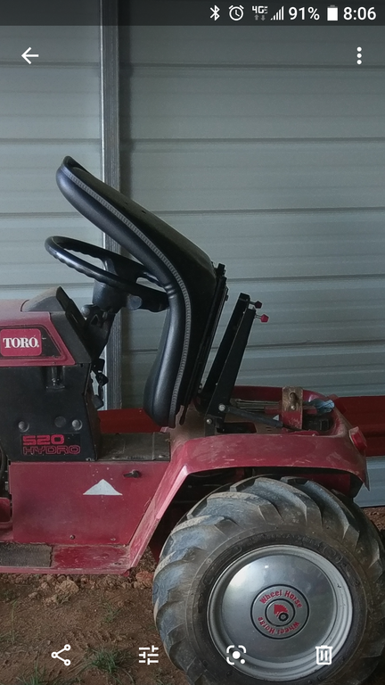

DougC 2,643 #5 Posted July 10, 2019 Going to remove the 2x4 from my 520H and install your fix. formariz. Looks classy and professionally done.. The 2x4 method I used came from watching Jethro on the Beverly Hillbillies......... 2 Share this post Link to post Share on other sites
