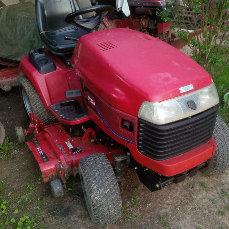

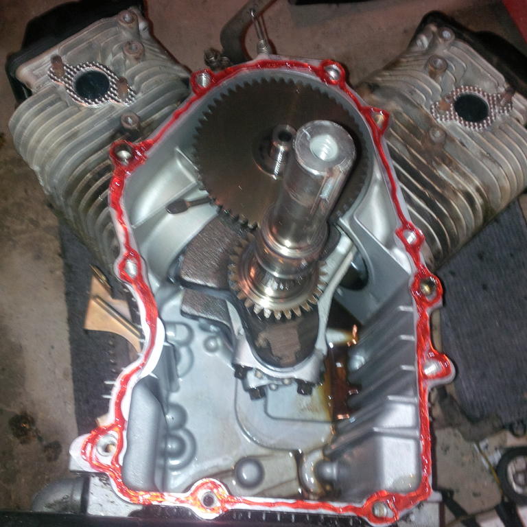

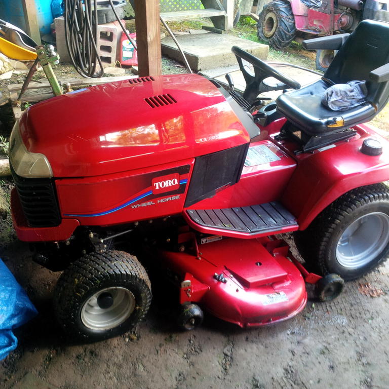

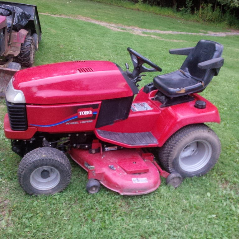

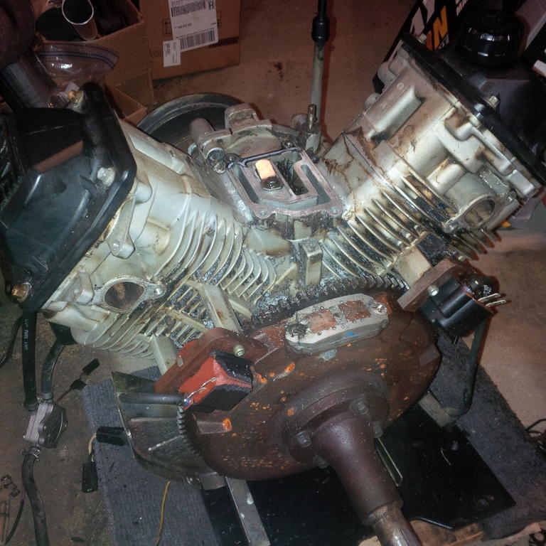

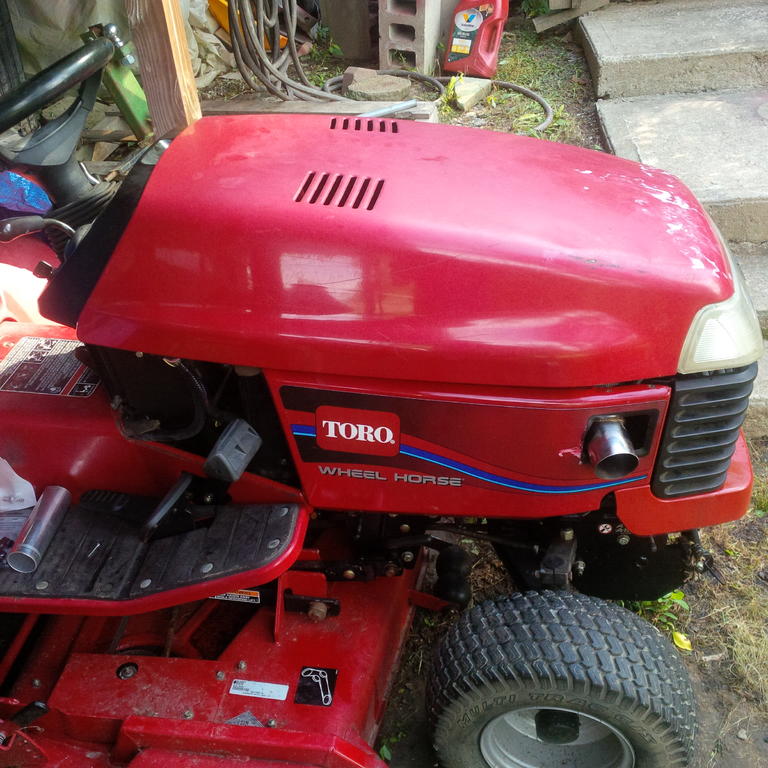

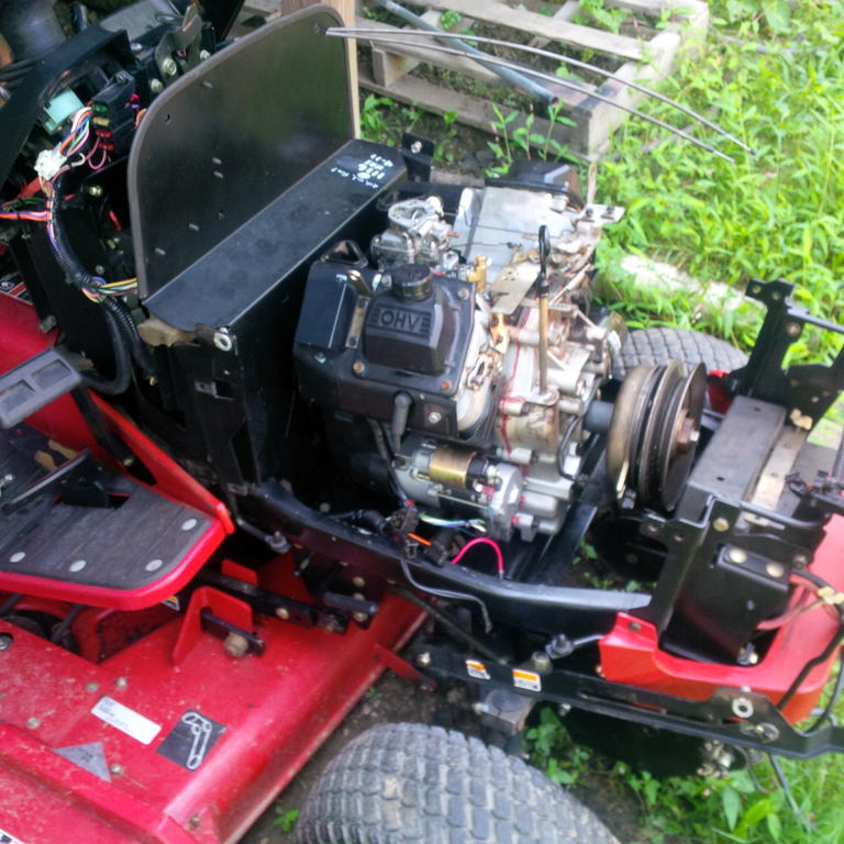

fast88pu 3,372 #1 Posted July 9, 2019 I picked up an xi a month ago with a major oil leak from the engine. So now the engine is torn out. What do you guys suggest I do to the xi? It will be a worker Share this post Link to post Share on other sites

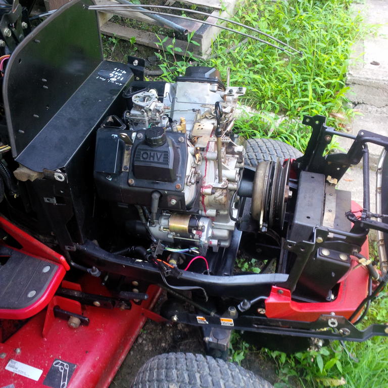

fast88pu 3,372 #2 Posted July 9, 2019 A few photos. Share this post Link to post Share on other sites
ebinmaine 78,240 #3 Posted July 9, 2019 Is the engine repairable? Share this post Link to post Share on other sites
fast88pu 3,372 #4 Posted July 9, 2019 9 minutes ago, ebinmaine said: Is the engine repairable? Yes. I am waiting on a new complete gasket kit for it 1 Share this post Link to post Share on other sites

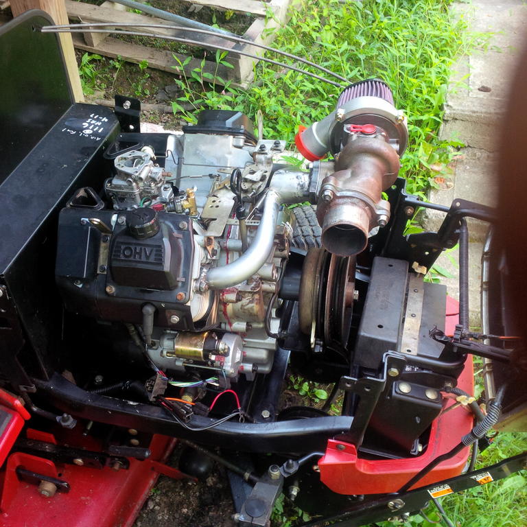

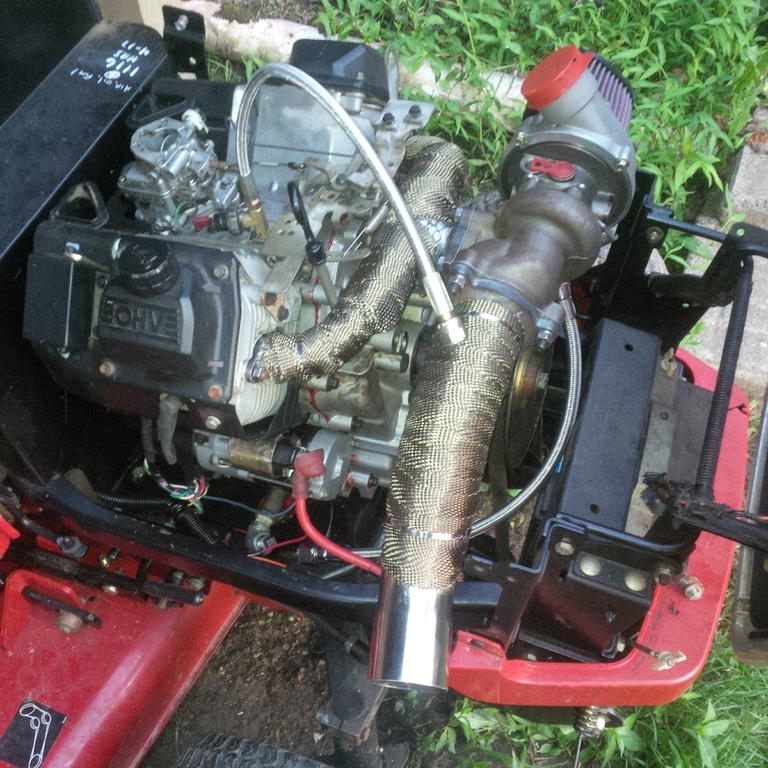

fast88pu 3,372 #10 Posted July 30, 2019 Engine is all sealed back up and mounted back into the tractor. 7 Share this post Link to post Share on other sites

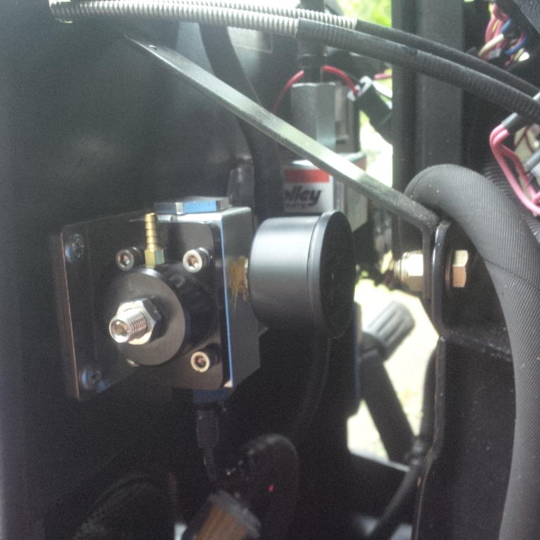

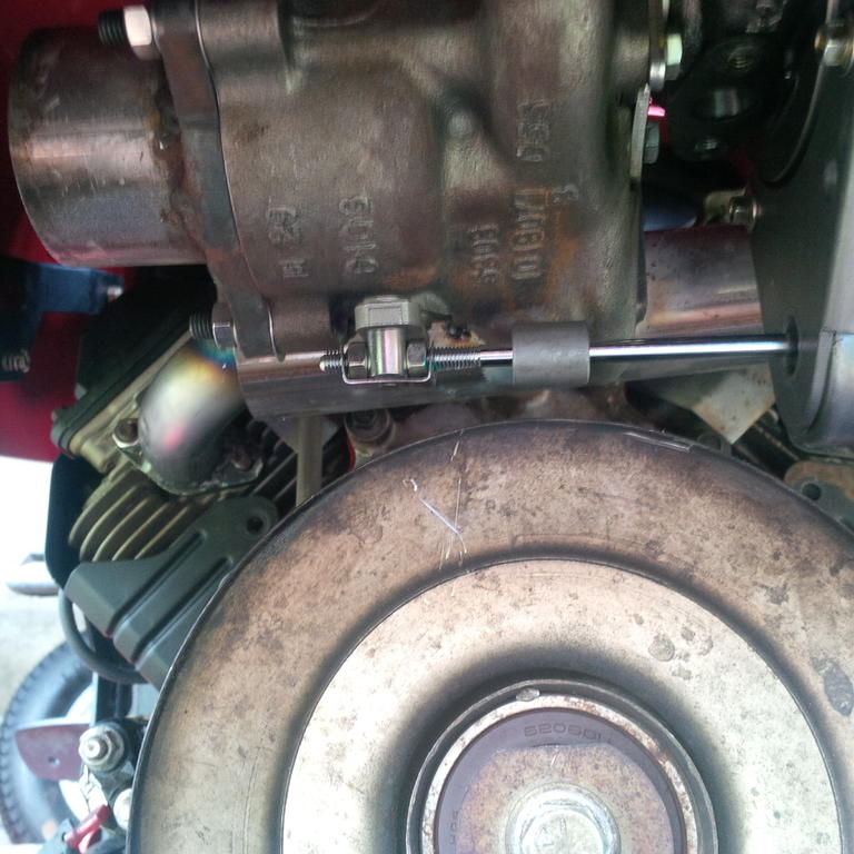

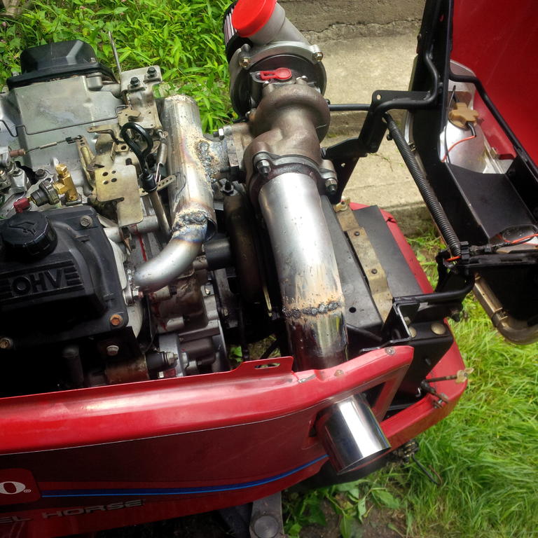

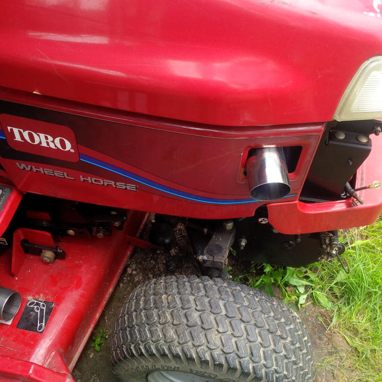

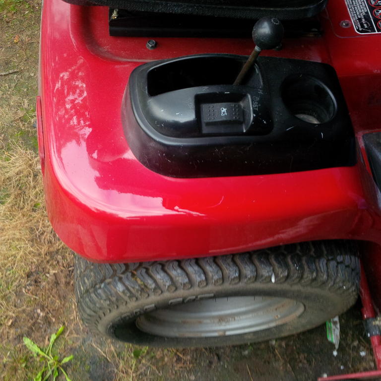

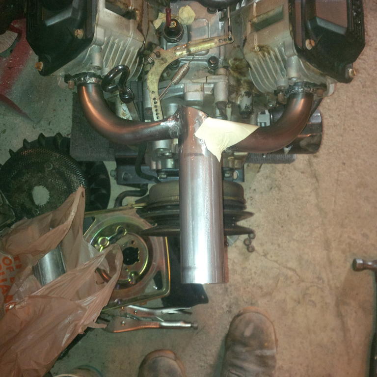

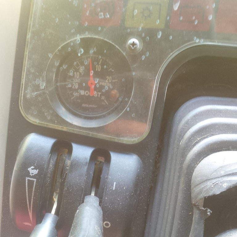

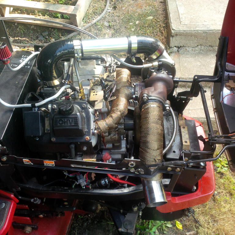

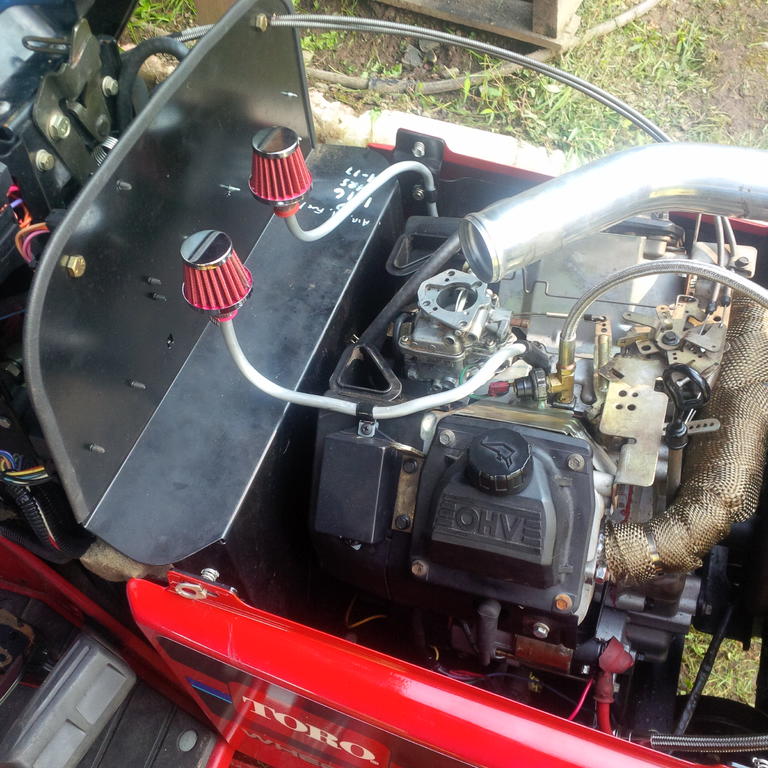

fast88pu 3,372 #11 Posted August 13, 2019 A few more photos of progress being made. 3 1 Share this post Link to post Share on other sites
ebinmaine 78,240 #12 Posted August 13, 2019 Looking good sir! Share this post Link to post Share on other sites
fast88pu 3,372 #13 Posted August 13, 2019 1 minute ago, ebinmaine said: Looking good sir! Thank you Share this post Link to post Share on other sites

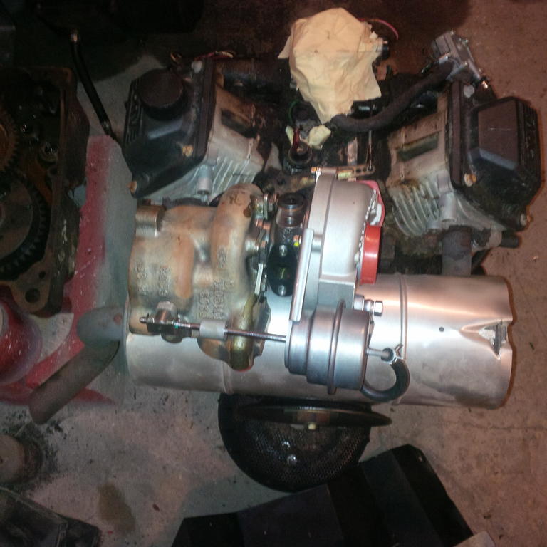

Pullstart 69,636 #14 Posted August 13, 2019 How’s it run? By the way, other than boost referenced fuel system, do you play with the jetting too, or is that a secret? Share this post Link to post Share on other sites
fast88pu 3,372 #15 Posted August 13, 2019 18 minutes ago, pullstart said: How’s it run? By the way, other than boost referenced fuel system, do you play with the jetting too, or is that a secret? So far I've used adjustable carbs and have had no issue 1 Share this post Link to post Share on other sites
Tractorhead 9,217 #16 Posted August 13, 2019 It’s maybe not real original 😂 i guess.... but things you changed looks really Bad Ass, curious for Soundcheck please Sir. 😎 Btw: Ain’t you use an Oil temp gauge to take care of your Engine ? I did a lambda adjustment ahead with a simple System on my Bike, but this System isn‘t available anymore. Actually they very cheap to buy, but are good enough, to get a usable Value for adjustment, but i think you did it allready? That‘s a real cool Sleeper, i like the Style 👍 Share this post Link to post Share on other sites

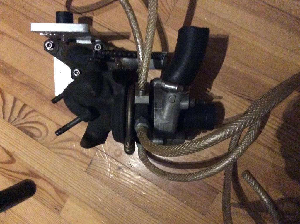

bds1984 1,506 #17 Posted August 17, 2019 Nice. I have a turbo off a 1.0 Ford Focus that is in need of a new home, most likely on a Kohler M18. What did your turbo come off of? 1 1 Share this post Link to post Share on other sites
ebinmaine 78,240 #18 Posted August 17, 2019 1 minute ago, bds1984 said: Nice. I have a turbo off a 1.0 Ford Focus that is in need of a new home, most likely on a Kohler M18. What did your turbo come off of? Oh you know you better be making a thread then.... 1 Share this post Link to post Share on other sites
bds1984 1,506 #19 Posted August 17, 2019 2 minutes ago, ebinmaine said: Oh you know you better be making a thread then.... I probably will. Who wouldn't want to see a 520H that has been pieced together from multiple tractors, powered by a Kohler from a Cub, with a turbo from a Ford? 1 1 Share this post Link to post Share on other sites
fast88pu 3,372 #20 Posted September 1, 2019 On August 17, 2019 at 9:38 AM, bds1984 said: Nice. I have a turbo off a 1.0 Ford Focus that is in need of a new home, most likely on a Kohler M18. What did your turbo come off of? A4 audi Share this post Link to post Share on other sites

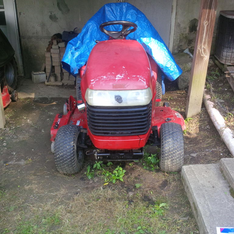

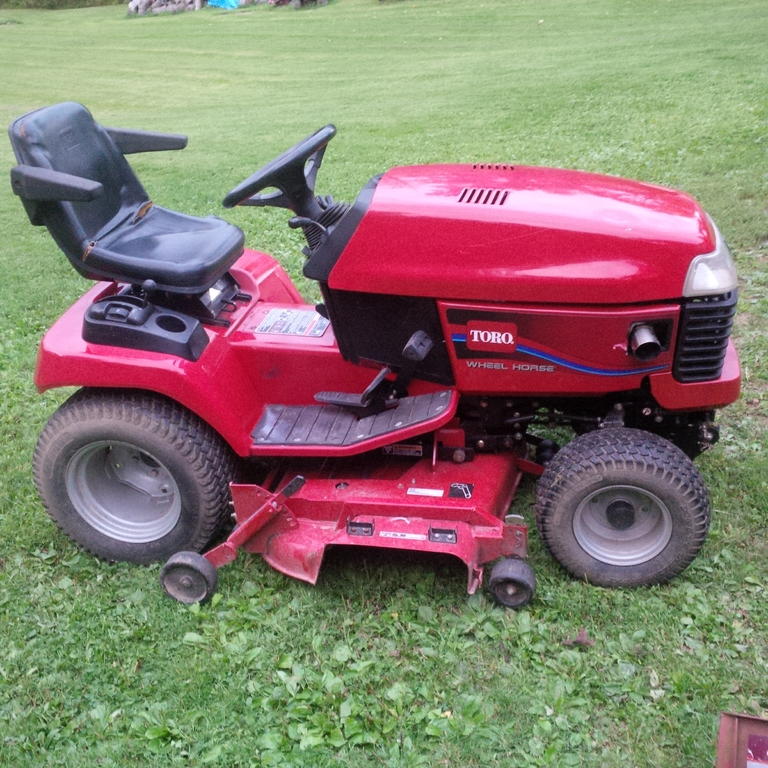

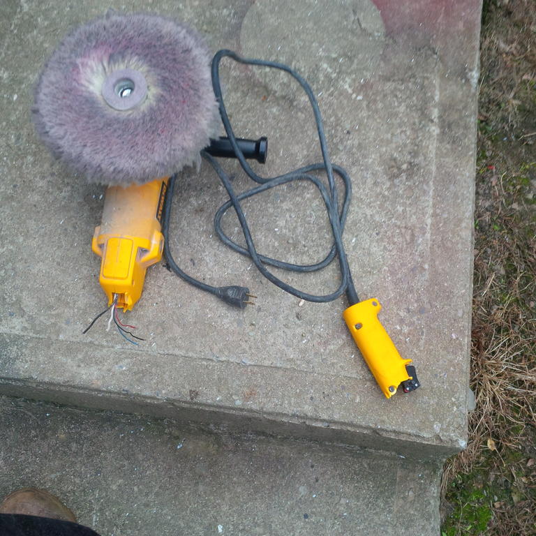

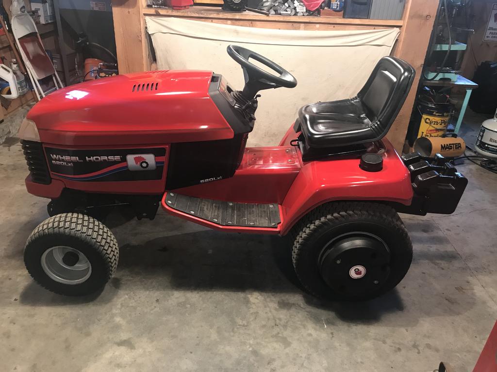

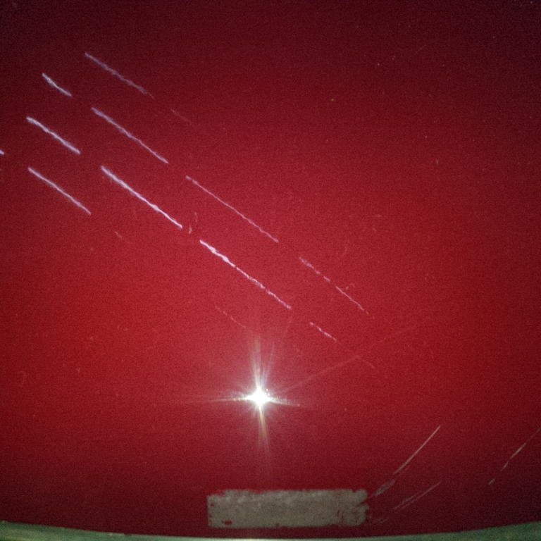

fast88pu 3,372 #21 Posted September 2, 2019 Finally buffed her out. Still not done 3 Share this post Link to post Share on other sites
fast88pu 3,372 #22 Posted September 2, 2019 Have to wait for parts for the buffer. It ate the cord. 1 Share this post Link to post Share on other sites

fast88pu 3,372 #24 Posted September 16, 2019 Sleeper pulling tractor in the morning. Mowing the lawn by the afternoon. 3 4 1 Share this post Link to post Share on other sites
