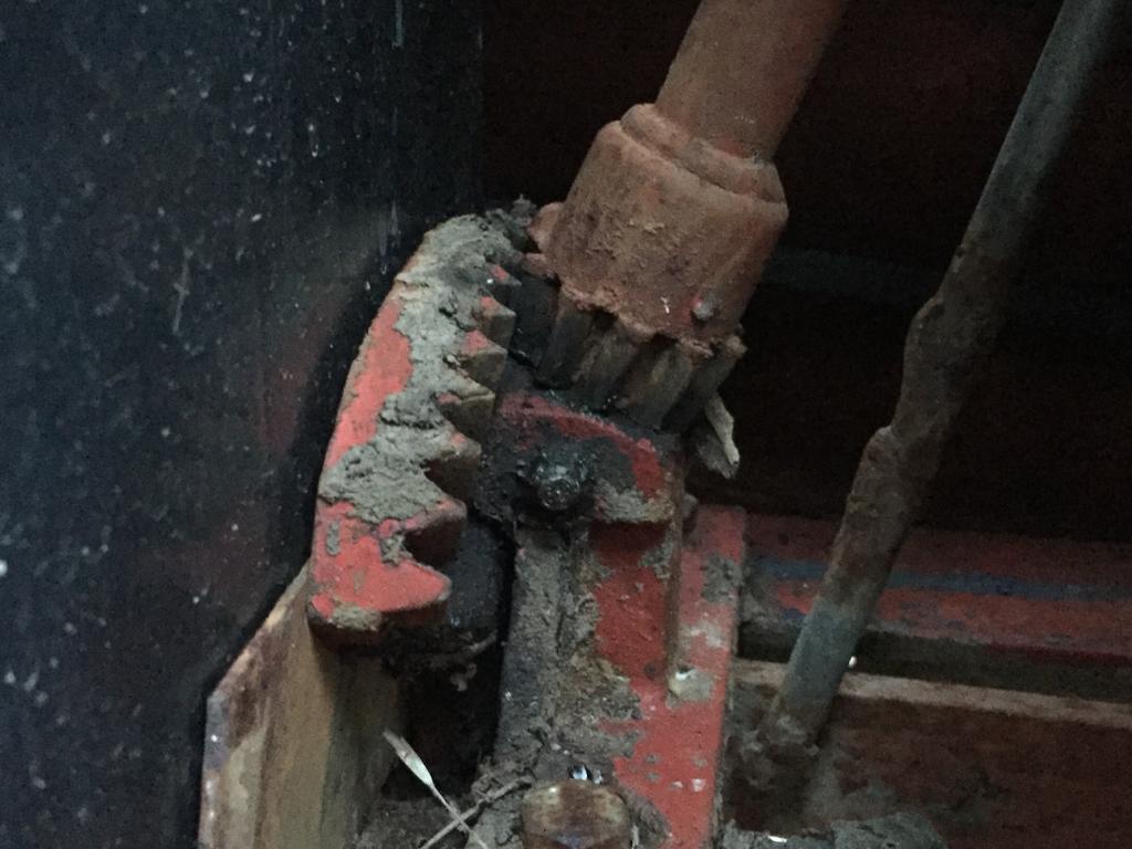

ZXT 2,402 #11 Posted July 10, 2019 4 hours ago, ebinmaine said: hey when you get a minute take a picture of what you think you may need. I'll see what I can find laying around. Sorry for not getting back promptly! Pictured are the steering gears on the C160. I figured I either needed to replace both gears or build some material back up on them. I can try shims, but I don't see that solving the problem long term, since the teeth are worn pretty badly. The picture makes the teeth look better than they really are since you're mainly seeing the outer teeth which obviously receive less wear. The steering shaft hole is egg shaped. I pushed around on it rather than just turning the steering wheel and it's worse than I thought. I'll have to address that, since it's what ultimately caused the issue. 1 Share this post Link to post Share on other sites
ebinmaine 81,146 #12 Posted July 10, 2019 5 hours ago, ZXT said: Sorry for not getting back promptly! Pictured are the steering gears on the C160. I figured I either needed to replace both gears No apologies necessary. Looks to me from here that your main issue is the lower fan gear. If you replaced that and either bushed or replaced the lower mounting block you'd likely be doing ok. Lemmme take me a look-see this afternoon..... I'm quite sure I have the fan gear... Maybe not the block. 1 Share this post Link to post Share on other sites
