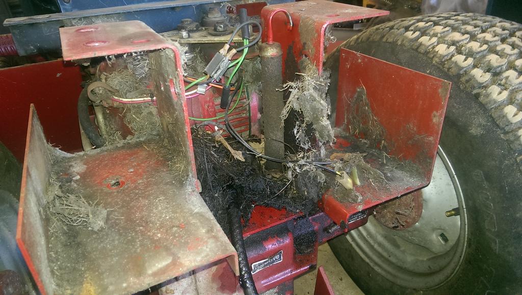

WVHillbilly520H 10,376 #2 Posted July 8, 2019 2 hours ago, Old CC said: A 1991 toro 522xi that has given good service for over 27 years, now suddenly overheating. Was mowing high grass, higher secondary to excessive rainy days, but not too high. Realized I was running low on gas, stopped to refuel. Had a new gas can, not metal but these new ones, went to new gas station, not the usual. Returned, fueled and started mowing..within 8-10 min..-pto engaged the temp gauge had reached the red zone and engine was loosing power. Shut her down. Did a test the next clear day, normal drive around at power......slowly over 8-10min reached red zone. (Note did not let it run in red) no pto. Any ideas, other than dumping the fuel tank, empty or change the fuel lines and filter.....checked oil, dirty will change. I would check actual temps with a laser scan thermometer, then temp sensor/sending could have failed, or in the 27 years have you ever pulled the engine and removed the engine tins/shrouds and cleaned the chaffe/dirt and other debris? If not this may be your biggest issue. I thought I was keeping my 520H clean until I had a trans temp light come on removed the fenders and found this...before pressure washing. 2 Share this post Link to post Share on other sites
shallowwatersailor 3,216 #3 Posted July 9, 2019 It sounds as if you have some how blocked the airflow to the engine with cutting the tall grass. Actually in the Kohler engine manual it call for removing the shrouds and cleaning the cylinder heads of chaff. You can clean about 3/4 of the top end without pulling the engine going from the top, but a thorough job will require the engine to come out. 1 1 Share this post Link to post Share on other sites
ZXT 2,401 #4 Posted July 9, 2019 (edited) When you clean the cooling fins, don't just knock the top layer dirt and grass off and call it a day. That'll restore the airflow across the fins, but it won't account for the oil/dirt grime that will be cooked onto them. Clean them good enough that you see bare metal. The fins don't exchange heat nearly as well if they don't contact the air directly. Edited July 9, 2019 by ZXT 1 Share this post Link to post Share on other sites
