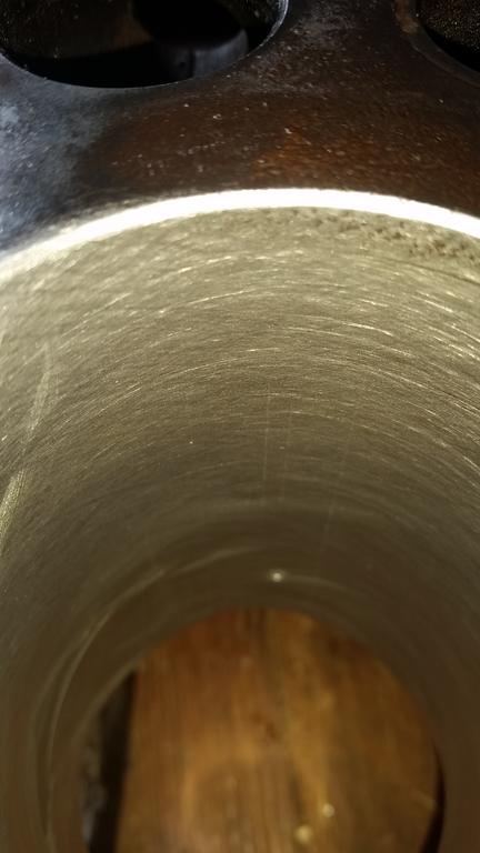

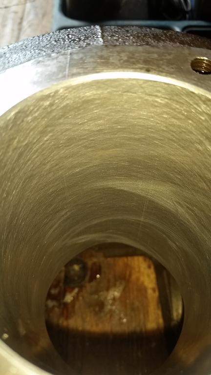

tntatro 181 #1 Posted July 8, 2019 Hello, I have a K181 to rebuild and it is a standard bore. The bore measures at about 2.9405 and the max wear limit is 2.941. Also, there are light score marks that would not hone out with a ball hone. The pictures show the scoring on the front and back of the cylinder. Is a cylinder in this condition normally rebored? The last K181 I rebuilt had a similar bore and I didn't rebore it. I installed used piston (new rings) and used rod and the valve guides were a bit worn and that engine runs good but let's out a puff of blue smoke on cold startup. Also, the crank pin was worn to its max wear limit. This rebuild has many new parts and the crankshaft is good, I just have to decide whether to rebore it or not. I picked up a new standard OEM piston for $30 just because it was a good deal but wasn't sure if I should use it on this one. 2 1 Share this post Link to post Share on other sites
953 nut 66,553 #2 Posted July 8, 2019 If you plan to work it hard on a regular basis it would be reasonable to spend the extra money for machining and a piston with rings. If it is going to be used as a cruiser to go around the shows and haul a wagon load of grand-kids then that cylinder should do well for you. 1 1 Share this post Link to post Share on other sites
tntatro 181 #3 Posted July 8, 2019 That makes sense. I'm just rebuilding some engines I got a decent deal on. With this one I guess it's best to rebore because it's getting new bearings and everything. Share this post Link to post Share on other sites
squonk 46,840 #4 Posted July 8, 2019 These engines get egg shaped cylinders a lot. Best to have a machine shop check it 1 Share this post Link to post Share on other sites
tntatro 181 #5 Posted July 8, 2019 7 minutes ago, squonk said: These engines get egg shaped cylinders a lot. Best to have a machine shop check it It is out of round but not outside of the wear limits according to the manual. I just found a new Kohler .010 piston kit for just under $45 so I ordered it. This engine is getting an all OEM new old stock rebuild (piston, rod, bearings, valves and even gaskets and seals are OEM). I managed to find decent prices on NOS Kohler parts on eBay. 1 1 Share this post Link to post Share on other sites
