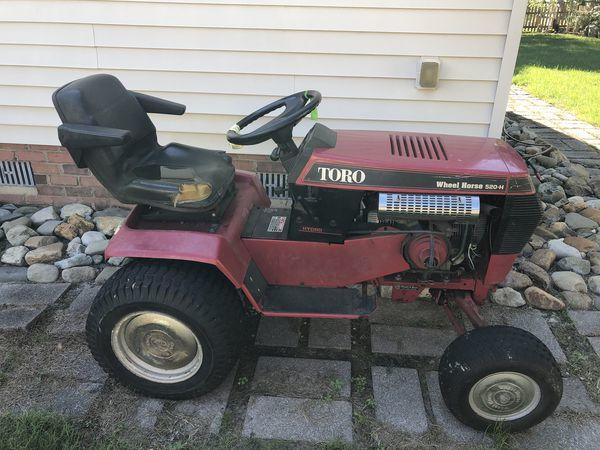

WHX?? 58,347 #9 Posted July 9, 2019 2 hours ago, lynnmor said: 700 hours should not be "tired" unless it was seriously abused Agreed Lynn. Lots of questions there, are the cooling fins plugged? Has the oil been changed regularly? Is the motor filthy with build up? Some pics here Tgalo would help. Anything else on the tractor look abused or jury rigged? Share this post Link to post Share on other sites
Tgalo 128 #10 Posted July 9, 2019 I'll get some pictures this week. Quote 700 hours should not be "tired" unless it was seriously abused Thats good to know, I haven't really took a good look at any of that stuff you mentioned.. Share this post Link to post Share on other sites
Tgalo 128 #11 Posted July 11, 2019 (edited) Ok so got to take a close look at this tractor. Found out its a 93 not 95. No oil leaks on the engine at all, In fact the engine looks pretty clean.I might mention I have not bought it from him yet. There are two hydraulic quick disconnects coming out the rear for some king of implement. But you guys weren't kidding, I could build a small block chevy cheaper... lol Edited July 11, 2019 by Tgalo Share this post Link to post Share on other sites
