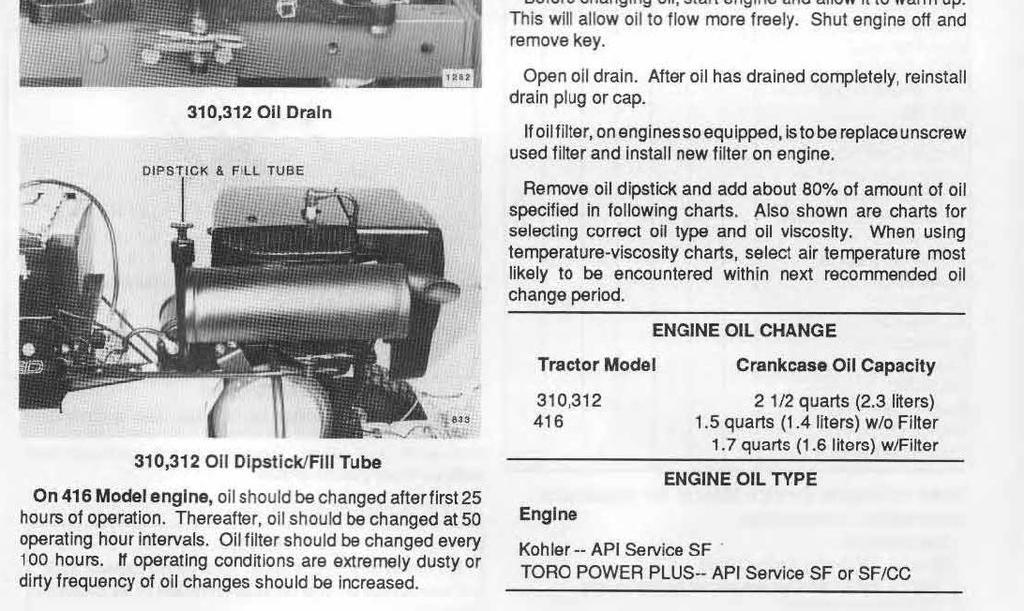

snowhound 106 #1 Posted July 8, 2019 Recently picked up a 312-8 with a Kohler M12 engine. The dip stick is broken could someone tell me how much oil it takes. 1 Share this post Link to post Share on other sites

LengerichKA88 1,885 #4 Posted July 8, 2019 (edited) Oil capacity should be 2.5 qts. http://www.tractordata.com/lawn-tractors/000/5/0/506-wheel-horse-312-8-engine.html if I’m wrong, someone will correct me. Also: Welcome to Red Square! Edited July 8, 2019 by LengerichKA88 Share this post Link to post Share on other sites

pfrederi 21,303 #6 Posted July 8, 2019 Owners Manual is a wealth of information https://www.wheelhorseforum.com/files/file/57-tractor-1990-300-series-8-speed-om-wiringpdf/ 2 Share this post Link to post Share on other sites
Mwheelb22 3 #7 Posted July 12, 2019 2.5 quarts. I use 10w30 with no problems. 1 Share this post Link to post Share on other sites

richmondred01 2,393 #9 Posted July 14, 2019 Yep 2.5 for your application. Share this post Link to post Share on other sites
