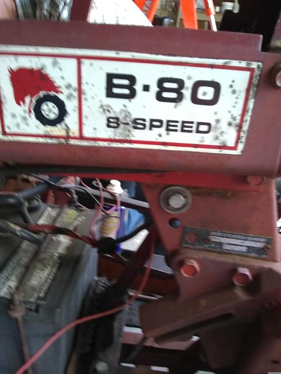

slapshot 2 #1 Posted July 7, 2019 (edited) I'm gathering info and parts for the B80 (1977) of my friends, and since it's 55 miles away, I like to have as much gathered as possible when I go to work on it. I think the last thing I need is to know what size the fuel line is, and how much do I need to renew it from the gas tank to the carb? Any suggestions as to type? Thanks for all your help! These are neat tractors! BTW, he's buying a new battery for it this week... Edited July 7, 2019 by slapshot Share this post Link to post Share on other sites
