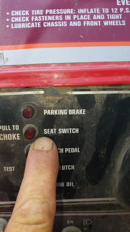

Ed Fox 20 #1 Posted July 7, 2019 Hello, thanks for the add. I'm having an issue with my 312-8. I ran it for about 2 hours. Shut it off for about 15 minutes. Went to restart it and it acted like it had a dead/weak battery. I also noticed with the key off the seat switch light was on but very dim. I jumped it and it fired right back up. At this point I still noted the seat switch light was on dim, dash gauge shows it was charging at 14 volts. I ran it for about an hour and when I shut it off it acted as if it was still dead. Any suggestions before I start throwing money at it guessing what the issue(s) is? I'm thinking a bad battery but why the seat light? Thanks in advance! Ed Share this post Link to post Share on other sites

Ed Fox 20 #3 Posted July 7, 2019 38 minutes ago, Digger 66 said: Welcome to Red Square . I'd like to try to help but I haven't the foggiest idea what a "seat light" is The light that comes on when your not in the seat and the PTO is engaged. Did have a slight change in the way it was acting, once I started it from a jump it seemed fine but now as soon as I disconnect the jumper battery it shuts down. Wont stay running under its own power. 1 Share this post Link to post Share on other sites

Ed Fox 20 #7 Posted July 7, 2019 3 hours ago, Digger 66 said: I pulled the battery out of my Cub and stuck it on the Wheelhorse. I pulled the incandescent bulb out of the display. Let see what happens. Im wondering if its possible I'm wrestling with two separate issues. A dead cell AND the ignition switch acting up. I've only had the wheelhorse for a year but I got it from a good friend of mine that was the original owner. It's pretty well maintained and only has 620 hrs on it. Hardly broken in. 1 Share this post Link to post Share on other sites
